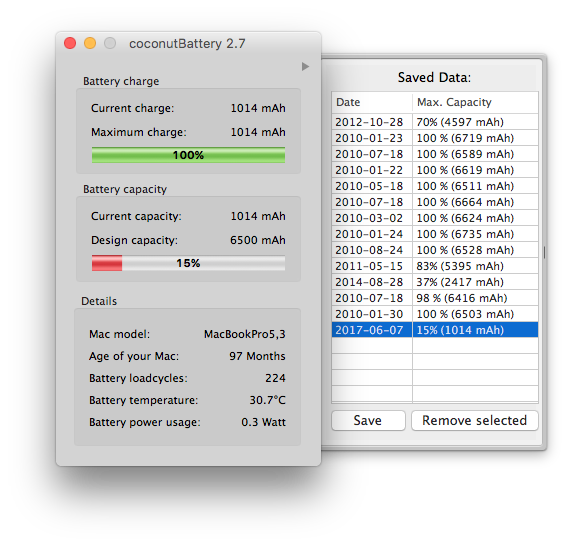

Just curious - what is your experience with the longevity of the batteries Apple puts in MacBook Pros? I've got a 15" mid 2009 model, which was the first one with the non user serviceable battery, which Apple advertised as keeping 80% of its charge after 5 years of use.
As you can see, I didn't use it too much, and the capacity already dropped to 70% after just three years of use. Now it's down to 15%, or about 40 minutes of real world browsing use. I'm using this machine as a stationary browsing device mostly nowadays, so it doesn't really bother me, but did anyone experience better longevity? I'm a little worried since it's even harder to replace the batteries of the newer models -- how much does Apple currently charge for a battery replacement in a current 15" MBP?

While many things play into the longevity of lithium cells, IMO, the rapid drop in capacity (provided Coconut Battery's logging is accurate) is not normal, and to me this suggests that your battery may have had some type of heat damage, overcharging damage, damage from improper storage, or had not-so-great manufacturing tolerances that caused premature wear. I believe Apple rates their LiPo cells with 2009-2017 MBPs for maintaining 80% design capacity at 1,000 charge cycles (with a cycle being defined by Apple as IIRC a discharge or more than 20% total capacity - how a cycle is defined can vary by Maker.)
