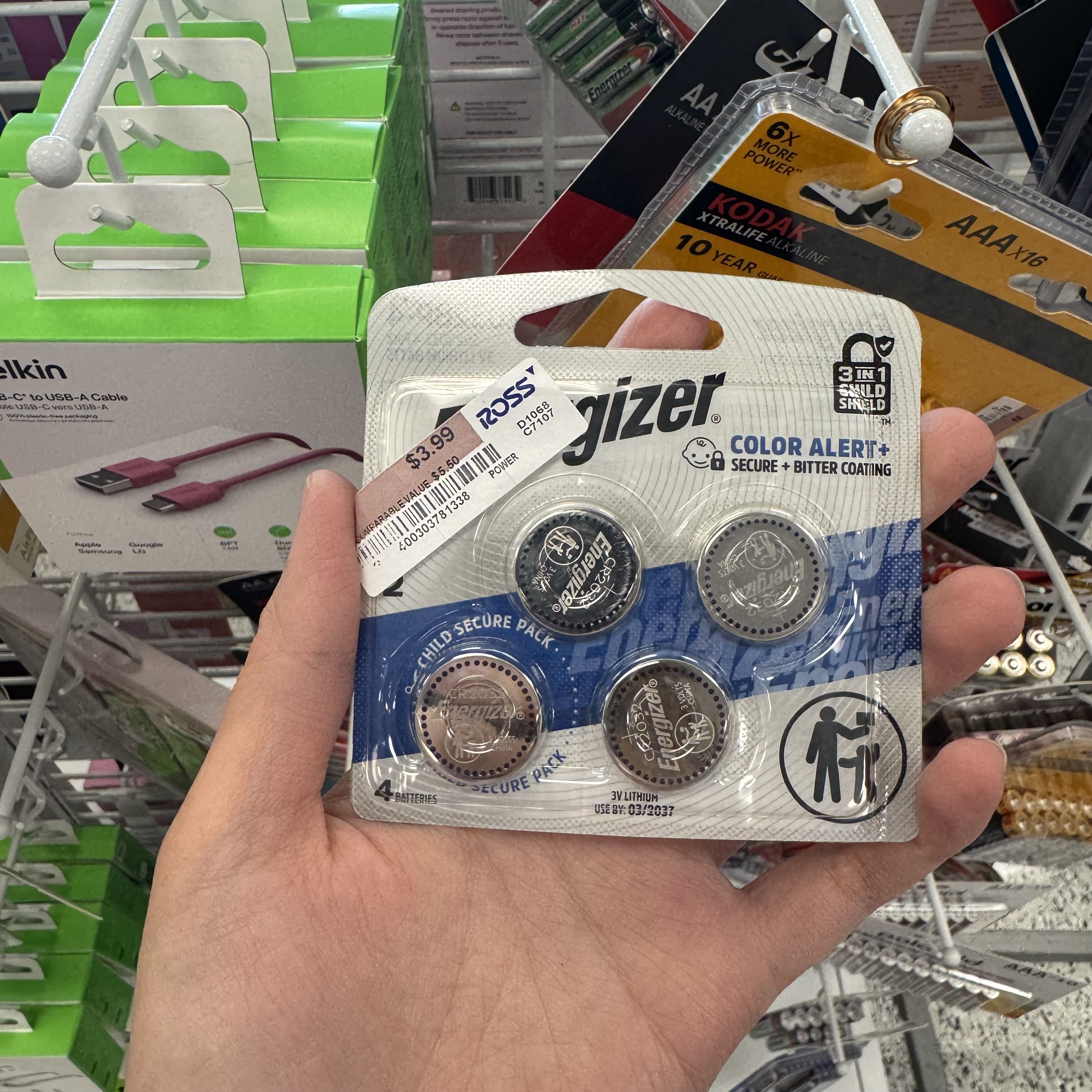

Like mentioned its typically the child safety bitter coating. It can add enough electrical resistance that when it's pinging iPhones the battery level drops to its low battery alert level. You can clean its off with isopropyl alcohol.
That’s the way. Also good for these batteries that have blue food coloring on them, but make sure to wash your hands when you are done removing it!

Got it! Also, keep in mind that third-party resellers selling those AirTags (especially if you are buying first gen ones ) might still be available if they’re old stock, which could mean the batteries might be dead when you buy them.
But if you use good batteries and clean them with sandpaper or IPA to remove any bitter or food coloring, you should be all set.
Sandpaper???

Buy less terrible CR2032 batteries.
Even uncoated ones from dollar tree still work well. A two pack of them are $1.50 compared to the much more expensive energizer packs in the store which aren’t worth it. I remember getting a pack of AG13s from that brand for an aquarium thermometer 🌡️ and it was $8 for a pack of 5 at target.
