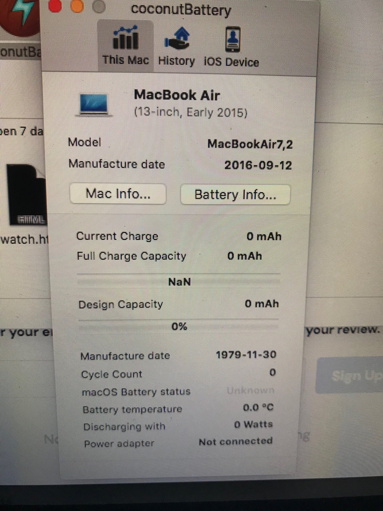

Well, the battery does not show a lot, even shows the power adapter is not connected (although it is). See att. I assume there could still be an issue on the main or I/O board too?
Based on the coconut battery report it sounds like the logic board is not working.
