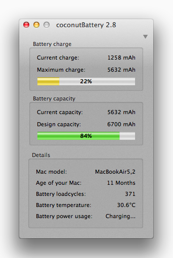

My 2012 isn't doing so good anymore 🙁
Look alright?
Not really, but as I said before, it fluctuates. How is your battery life?
Well I used to be able to watch 1080p mkv's for a good 6-7 hours after the 10.8.X update that fixed the battery life
Now I'm getting around 5, and like OceanFrog said, under his conditions, I get aroud two and a half hours.
