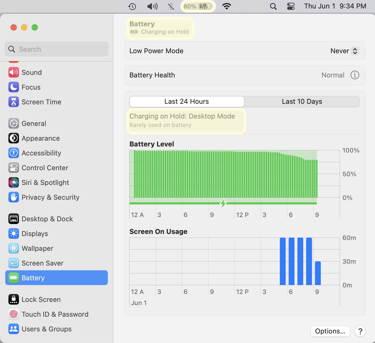

Well, lookie there... after 3-4 days, it appears the battery optimization algorithm "learned" that my system is always connected to the a/c charger, and decided to reduce the charge level to 80%. It appears the discharging process began around 6am today (while the lid was closed and sleeping). And finally completed around 9-10pm this evening (while the lid was open and I was using the laptop).
Couple of noteworthy observations (highlighted in yellow highlighter in the attached screen shot)...
- On the System Settings->Battery page, you can see;
"Charging on Hold: Desktop Mode" "Rarely used on battery"
- In the menu bar, the battery status icon has changed from a lightning bolt to a two-prong a/c plug
Also notice the output of sudo pmset -g rawbatt
Interestingly, the percentage reported in the menu bar appears to be;
current capacity/(design capacity-200) (ie. 6792/(8700-200)=.80
Whereas the percentage reported in pmset -g rawbatt appears to be;
current capacity/full charge capacity (ie. 6792/8856=.76)
Code:
06/01/2023 20:47:42
 AC; Not Charging; 76%; Cap=6792: FCC=8856; Design=8700; Time=0:00; 0mA; Cycles=6/1000; Location=0;
 Polled boot=05/30/2023 18:41:30; Full=06/01/2023 20:46:34; User visible=06/01/2023 20:47:34
