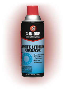

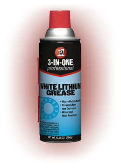

Lithium grease can se used on battery terminals to help prevent corrosion.

at autoparts stores they sell some spray on stuff that reduces it.

Here is one spray can version. I usually use a tube.
