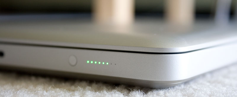

When you mention the battery indicator do you mean the green light at the end of the charging cable or the menu extra?
battery indicator lights = the 8 little green lights on the side of the mpb, connected to the logic board.. i accidentally broke that cable 🙁
pic attached, not my computer, pic taken from gizmodo.
