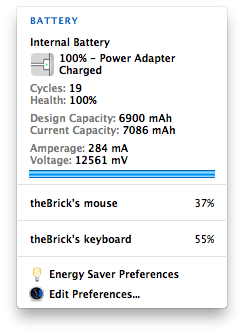

mine shows like this...
Current Cap is still slowly growing w/ each charging, Obviously lol

Don't sweat the 6900 or 7086 mAhr number or whatever, it's just a wild guess by your Mac. Your Mac doesn't really know how much juice is in your battery. The only way to find out for sure is to run it down to dead empty - ie calibrate it - and see how much juice comes out. But next time the answer will be different:- temperature, age etc will all affect the answer quite a bit (maybe as much as 10%).
I wouldn't even bother calibrating it unless you really want to. Calibration doesn't make the battery any "bigger" or "better", it just makes the on screen display (hours remaining) more accurate. And calibration involves running the battery to completely empty which is not particularly good for it.
