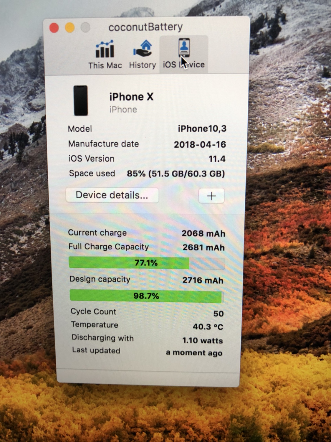

It’s discharfing at 2.43 watts atm according to coconut.

Are you using your phone while charging? phone temp. reads 40.3 celsius.
Yes which is the problem itself. Went there and they said I just needed to do a fresh re install of the OS. Didn’t realize I could just do it on my computer

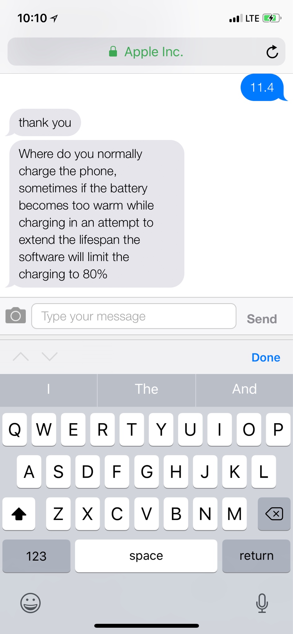

Ok it seems my issue isn’t solved. Their diagnostics said it’s fine and everything went fine at the store but now it has happened again once it reach to 80% . I think the problem is the 80%. This is really annoying since it took me over two hours to get to the Apple store and now I have to go back there again.
And this is their new excuse... honestly almost wish I just stuck with my Note 8
I don’t see it as an excuse. They’re simply asking you a question. Just explain the situation. Apple has always been awesome in terms of customer service.
How is that an excuse? Your phone was at 40 Celsius. That is very warm. Anything over 38F triggers the phone to go into "overheating" mode, which will limit the device from charging and dim the screen. Put your phone down and let it cool off. Its that simple.
Oh, and just because you told me to bet on your battery being defective. I see that you went to the Apple store and it passed, therefore, not a lemon that you told me to bank on.
The only advice that I have for you is to study and research how batteries actually work, then you won't need to get so worked up over your batteries.
It could be anywhere. It happened to be at 40° that time. Unless using safari to do the chat makes it 40° then the phone still has a problem. I quite understand how battery’s work and this one has been a dud since the start
