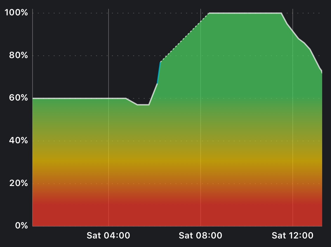

Here's an example:
I fully charged my iPhone to 100% and left it plugged in for 2 hours after it initially hit 100% (which I only do maybe twice a year to calibrate the indicator) and I used it right afterwards continuously.
I unplugged it at 8:30 AM and the battery indicator stayed at 100% for 3h 45m before it finally began to budge. Obviously that's impossible.
