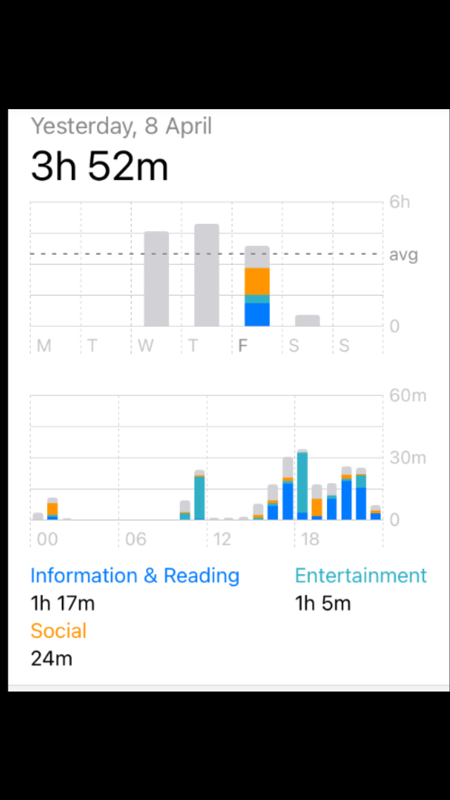

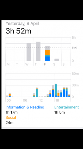

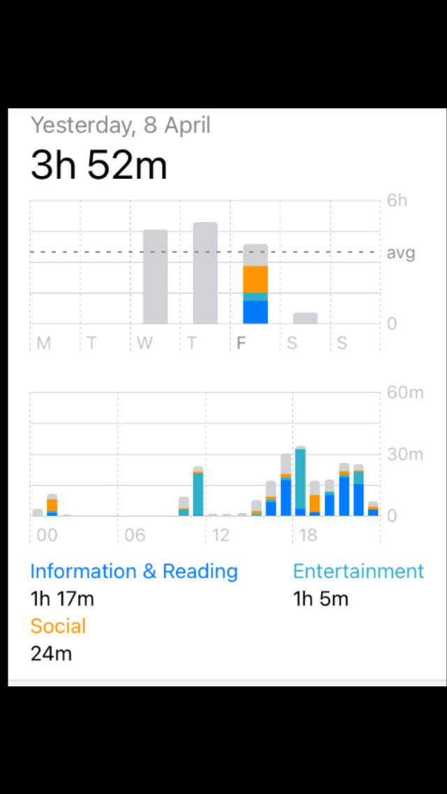

That’s me completed a day of use on my Gold iPhone SE with the brand new aftermarket battery installed. Those are the results which aren’t bad considering I have been away at work all day and have been on 4G which requires more battery draw than WiFi. I also managed to stream 1.5 hours of podcasts on earphones on top of that screen time. I think that’s a decent result considering the SE’s battery is something tiny like 1600 mAh.
