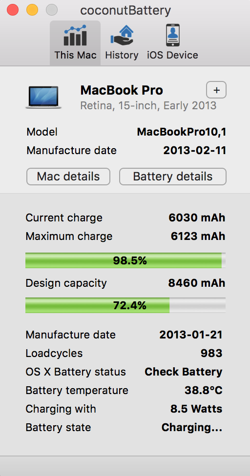

Does the battery specifically say SERVICE battery? Can you post a picture of the battery capture with something like the coconut battery program? The reason I ask is that I'd like to see the condition of the battery.
Don't feel bad about the applecare running out. Once it reaches around 900 cycles, it is really hit or miss if apple will replace it. Those who have had their battery replaced by apple tend to have good experiences but you want to BACK UP EVERYTHING before you send it away.

Appreciate the help you all!!
and Thanks man, yeah it says "Service Battery" on the menu bar when I click Battery.

Don't replace the battery yourself. Too much risk. The battery doesn't look that bad actually for almost 1000 cycles. Like I said earlier, I would invest the money into another macbook pro. Some people have a great time with macbooks lasting 5-7 years or more, but at the 3 year point and with that much usage, something else could easily wear out/break on your current system.
