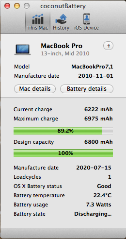

Yesterday I replaced a battery in my Mid 2010 MacBook Pro with a 2-power branded battery.
