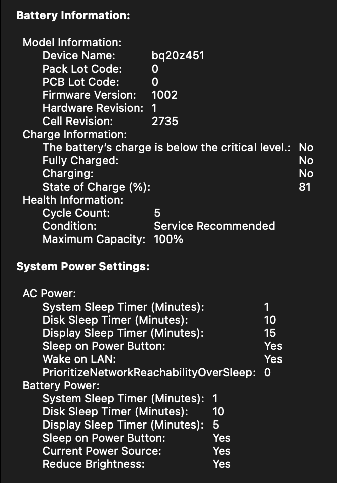

Did you get this issue resolved? I'm getting the same issue on my new M1 Air. Showing 100% capacity with 5 cycle counts so everything looks new, but seeing service recommended. Is this a software issue?
I had/have the same exact issue on a new M1 Air, 8 or 9 cycles on the battery.
I took it in to Apple and they wanted to 'capture' my device and send it back to their engineering team. They're replacing a CTO 8/8/16G/512G with an 8/8/16G/1T build as they didn't have any stock of the 16G/512G.
I used an Anker USB-C -> USB-A/Ethernet/USB-PD hub once or twice. I saw a mention on one of the other M1 bricked threads that a guy used the same adapter and shortly after received the 'service battery' error. I can't say whether or not this happened before or after using the adapter and I'm not sure I ever applied USB-PD power through the dongle. I do know I only ever saw the service battery warning after updating to 11.1.
I assumed it was software but perhaps not?
FWIW: Apple support wanted me to do a clean install prior to bringing the device in. I did partition off and install a second 11.1 OS - same service battery error on the clean install.

Apparently the SMC reset procedure for the M1 is to shut it down, let it sit for 30 seconds, and boot it back up. I tried this and I also tried running the battery down to 0, letting it sit for 5 hours and charging it back up. Neither of these had any impact on the warning.

Did Genius offer to replace battery or thoughts on the cause? Software or hardware issue?
I ran diagnostics and there were no issues found so thinking it might be a software bug

They never offered to replace the battery, it seemed like they wanted to whole machine - which I found a little strange.
