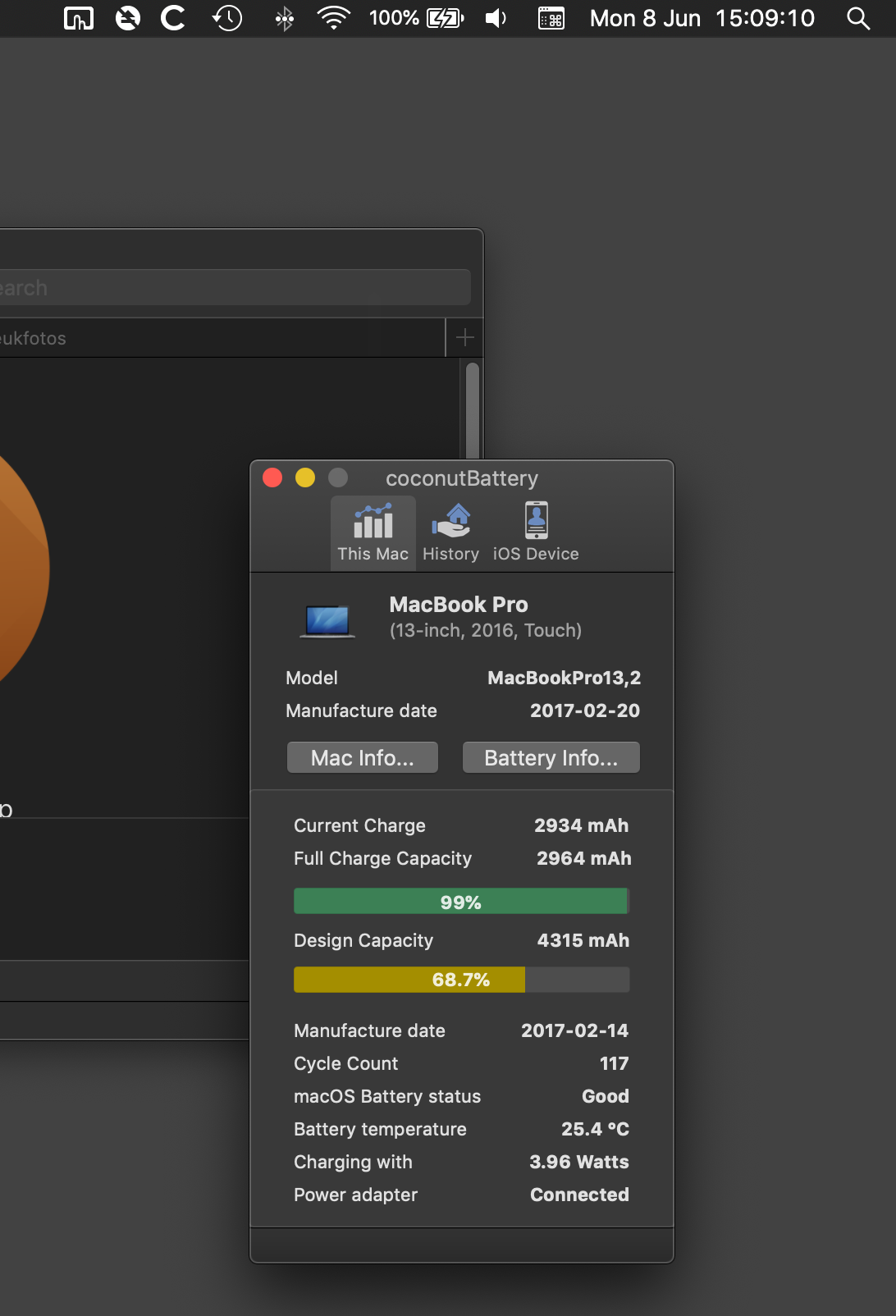

However, after running Security Update 2020-3 a few days ago, System Report now says my battery condition is "Normal" and according to coconutBattery it is "Good". System Report states a Full Charge Capacity of 2964 mAh, while I know the battery's design capacity is 4315 mAh. So only 68.7% of its Design Capacity is left at (now) 117 Charge Cycles.
How is that "Good" or even "Normal"? How can a battery that needed replacement suddenly be acceptable when in fact its condition is worse? Only when I boot the laptop holding the "D" key, the diagnostics tool tells me the battery needs replacement.
Don't worry, it will go back to "Service Battery" in no time. Give it some load, run CinebenchR20 or Handbrake.

Status update FYI: The "service battery" status came back after having been gone a short while. So, a week ago, I brought the laptop in for repair.
Apple replaced the topcase (battery & keyboard) of the MBP under warranty. Cost to me is € 0. I can pick it up tomorrow. Nice!
