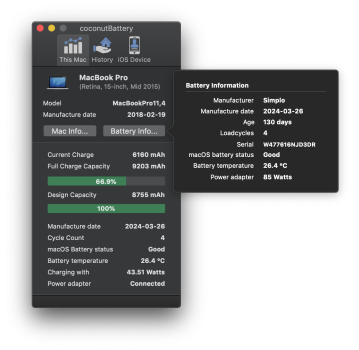

The new battery is working like a charm. However, manufacture date and battery temperature, as it can be read with Sensei, Coconutbattery or Aldente, are not shown correctly. The data reported seems to be same of the old battery, so that I tried to clear SMC settings.

Manufactured by Simplo. There seems to be a discrepancy in the specs: design capacity is 8755mAh, as reported in Coconutbattery, whereas full charge capacity is 9203mAh... which likely suggests that battery chips may have been manipulated.

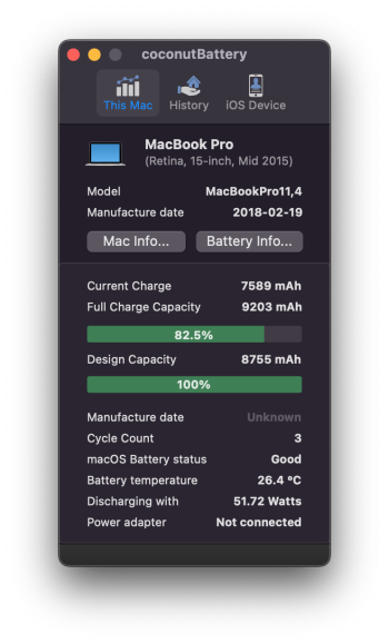

Re-installed coconutBattery as suggested, and now manufacture date is "unknown".
Temperature remains constant at 26.4º (same data is shown by Sensei and Aldente).
Thank you for your suggestion.

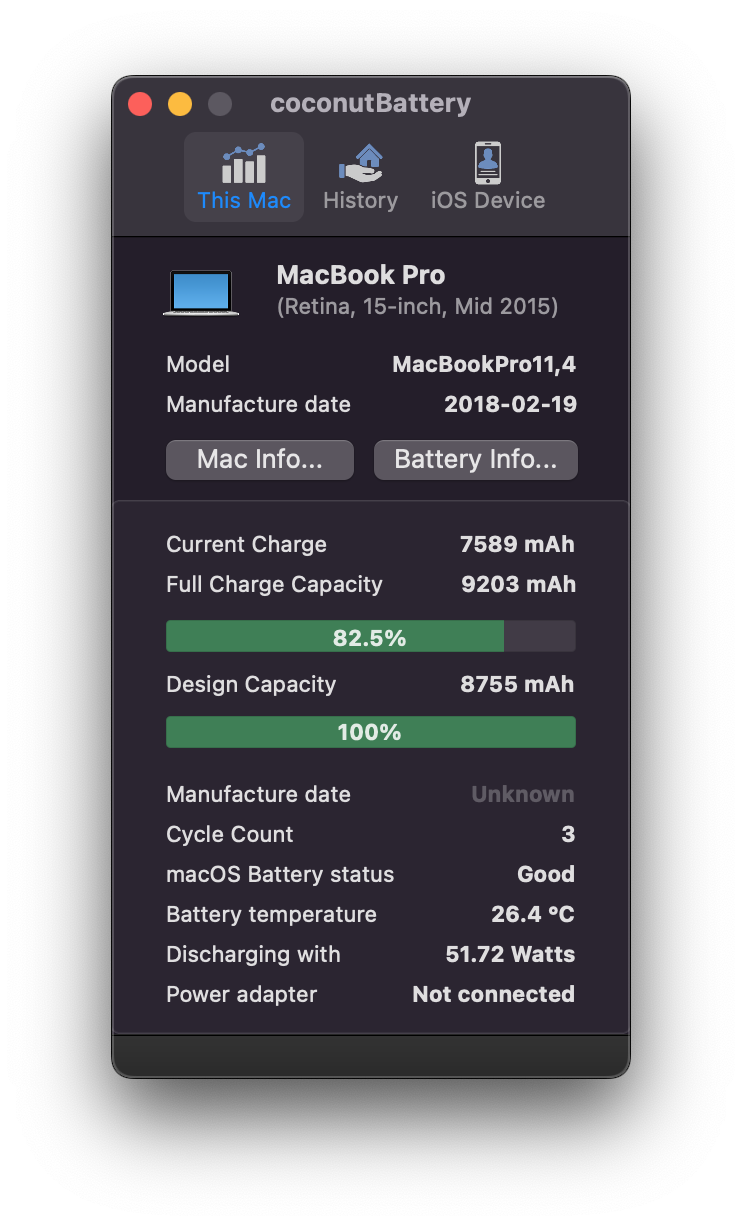

Still nothing.

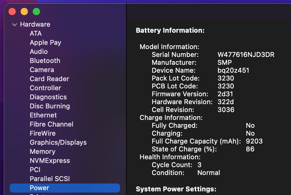

Is there any suggestion of third party battery replacements, in addition to OWC and iFixit, that allows the system to monitor battery temperature and aging?

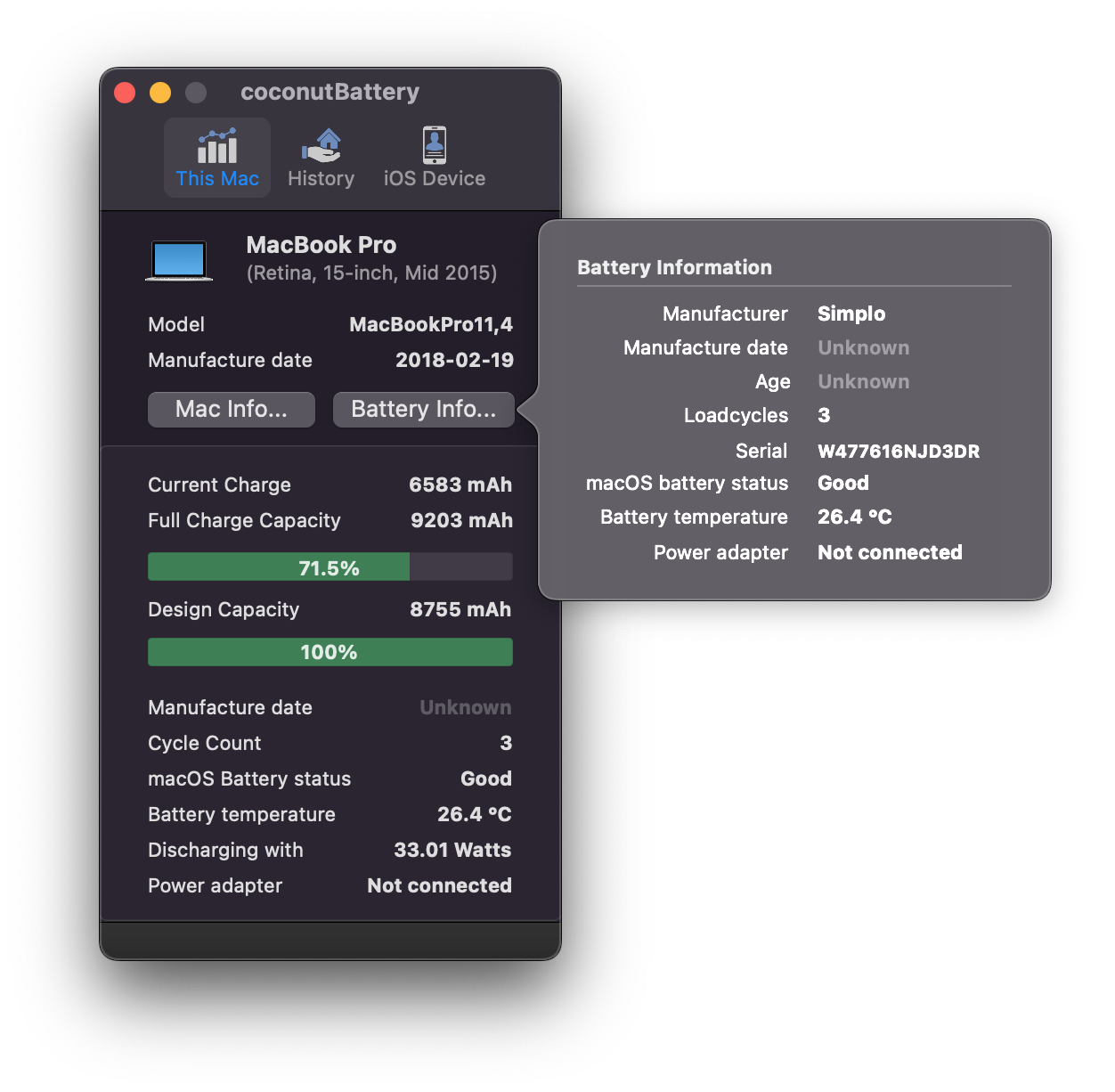

Post screenshot of window appearing when you press "Battery Info..." button...

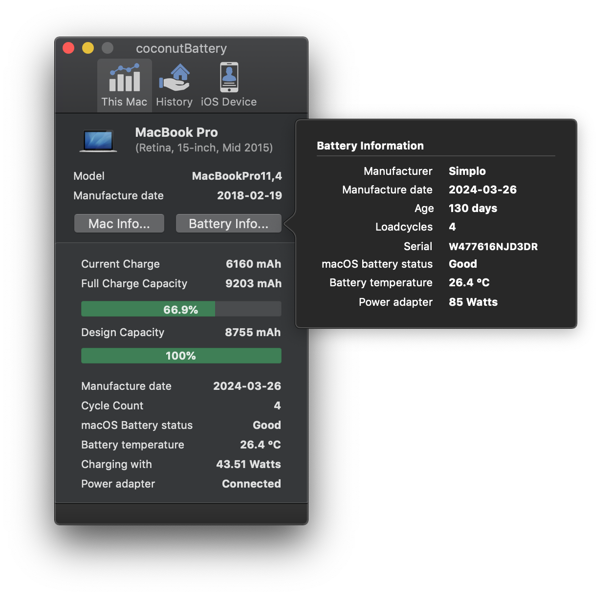

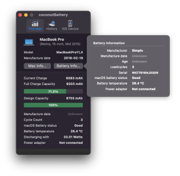

After installing Mojave, I checked coconutBattery and now manufacture date is shown correctly. However, temperature is stuck at the same data.
I'd read a costumer review of a similar battery for the same model listed on Amazon, who contacted technical support for the same problem like mine, and they said that macOS 10.15 and beyond can't read properly temperature and manufacture data in third party batteries.
That may explain why Mojave is showing the information correctly, whereas it was missing in Monterey.
