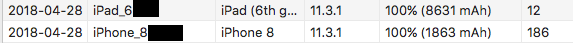

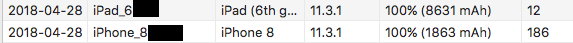

Check out my 8+ records: (Ignore the center columns as they're for my own OCD and have no meaning without a lot of explanation (I redded them out)). I have graphs and other things as well (off to the right) 🙂.
Sure it is unlikely that capacity drop like this is not going to cause problems right away, but in case it is really going down so fast in the begin with it will bite you in the butt later on.
Your 8+ records looks just like what I would expect from good battery. It seems to be even after 6 months still slightly above nominal capacity. Of course it will fluctuate some, but like seen in your chart, deviations are quite small, and again well above 100% and never below.

Interesting results but I wonder how you get 100% condition for both? For iPad 100% should be 8827 mAh and for 7 1960 mAh. Looks like your iPad is about 200 mAh and iPhone about 100 mAh below what they should be. Of course your iPhone has quite many cycles already so this wear is likely normal but your iPad has only very few cycles.
For my iPad I get just below 8400 mAh, for example today 8366 mAh and that value is from outside app source. My iPad battery has only 5 cycles. Actually apps also seems to give reliable readings, they are just rounded up to nearest 100. So when app said today 8400 mAh it was actually 8366 mAh. Voltage reported by app was spot on, again rounded so that when app said like 4.10 volts it was actually 4.0980 volts. My point being here that thing are actually worse than what app says, not the other way around.
Then again my iPhone after 50 cycles is still slightly above nominal capacity!
