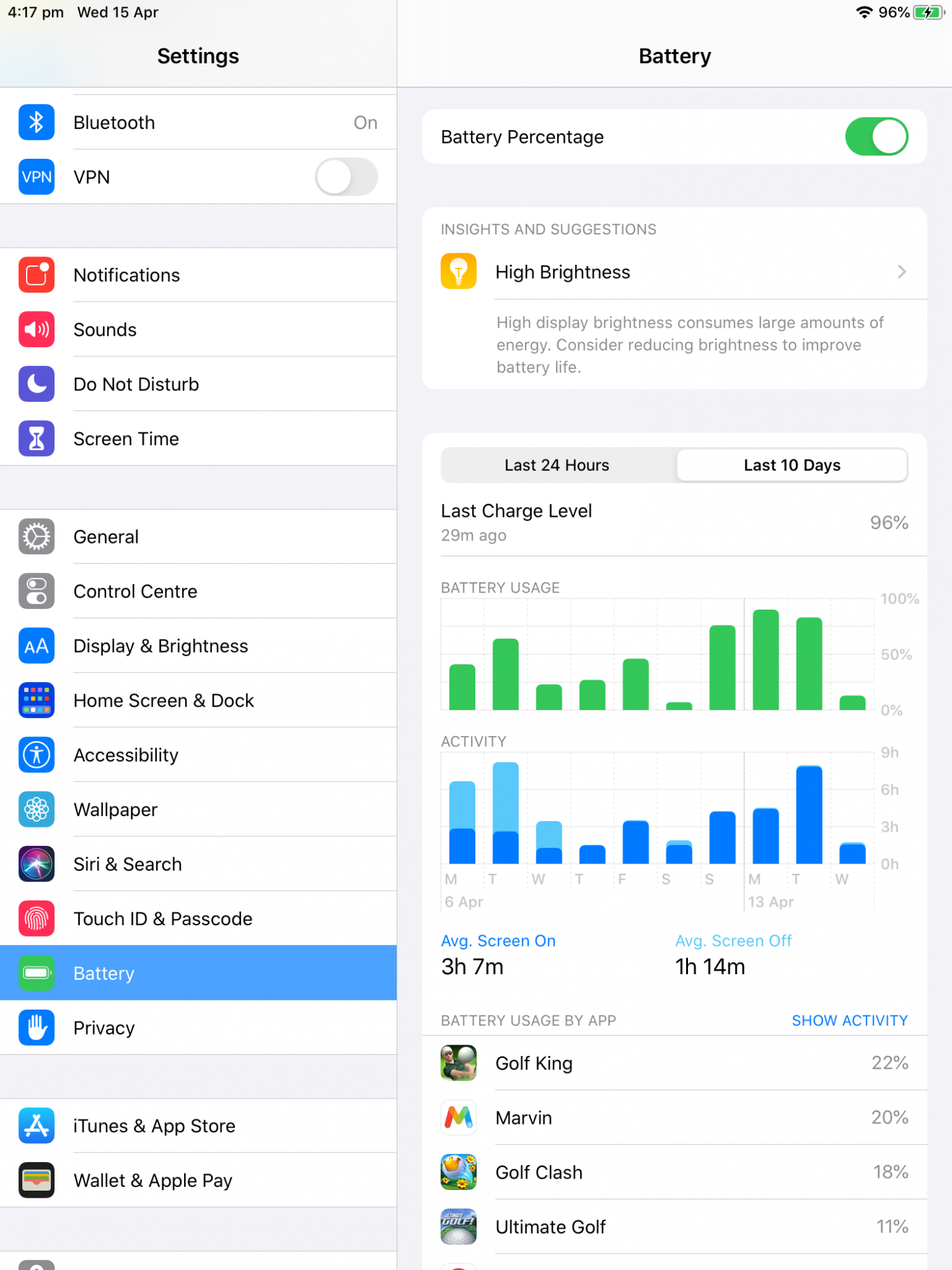

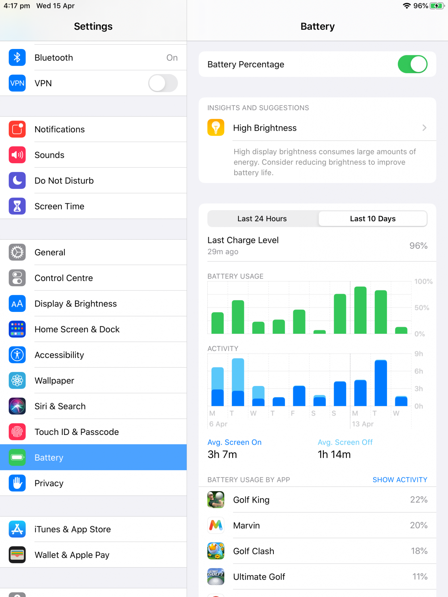

I Have an iPad 5th gen (according to Imazing). It seems to take ages to charge (yesterday the battery was at 7% and took about 6 hours to charge from about 9.30am to 3.30pm (was working so these are estimates but an app, battery HD+ i have on it said 6h 30m to charge). I thought this was a really long time to charge. I have never really noticed before as i charge it overnight.
However i was looking around and another app battery & charger Test has the health as Good which is fine but another app someone mentioned when i googled looking for apps to check the health is "Battery Life"Battery Life says the battery wear level is at 35% - Very High. I am not sure how accurate these are and wanted someones opinion as thought it might be going. I play a lot of games and read (Mainly couple golf games & Snooker games) and just browse the internet. The Average Screen on time is 3H7m and Off Time is 1h 14m in the last 10 Days (according to the battery in the settings, Pic attached).
I just bought a new charging cable and plug from amazon and the battery HD+ app says the same times for charging for both the old cables/plug and the new ones.
Any help would be appreciated.
Keith

Regular iPads do charge slowly. My regular iPad (6th gen) takes at least 5 hours to charge (from 15-20 % to 100 %). In terms of average screen time to be honest I never managed to have more than 6 hours per charge.
How long have you used your iPad? To me it seems that it did take a bit longer than normal to charge and the screen time you are sharing is rather less than normal for those iPads.
Did you check the charge cycles with iMazing?

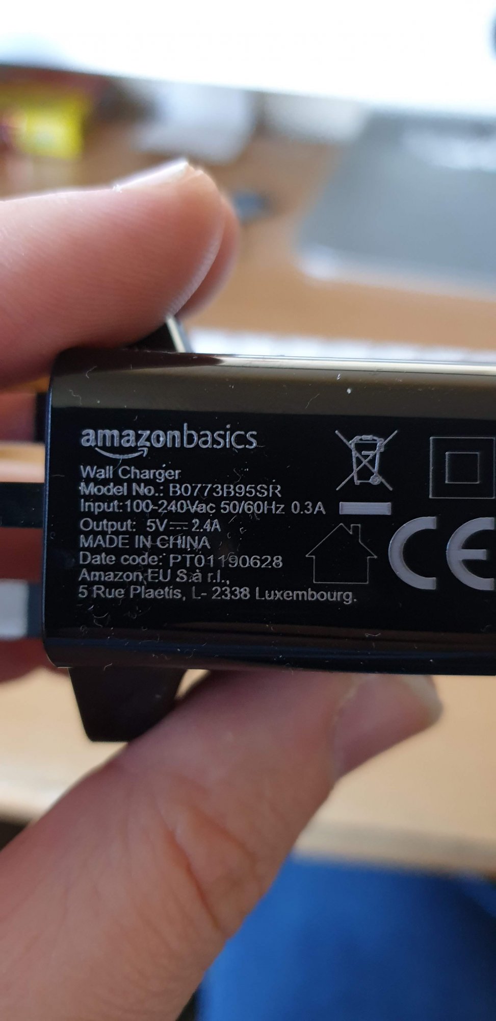

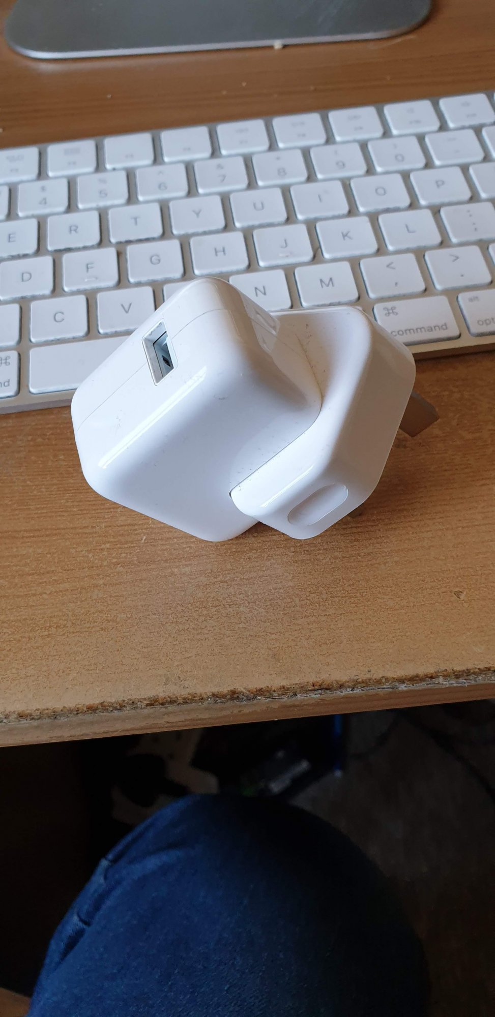

Do you use your regular charger that came with the box? I think that it was 10W. I bought another one that is 12W. It does improve things a bit but not a lot. However I was told that the regular iPads do not support fast charging and I should not use chargers above 12W(cannot tell you if this is true or not). Otherwise I end up risking swollen battery situation.
I have had a mac for years but this is fairly new at ipads and they do most of what i want (reading/playing Games Occasionally shopping (amazon/Asda/tesco)). Glad you think that just worried i had 2 different diagnoses for the health, though i would probably choose Imazing as i like the app.
I just bought a new charger (as mentioned in my original message) but not an apple one.

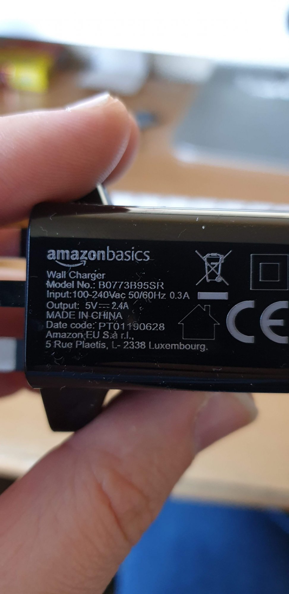

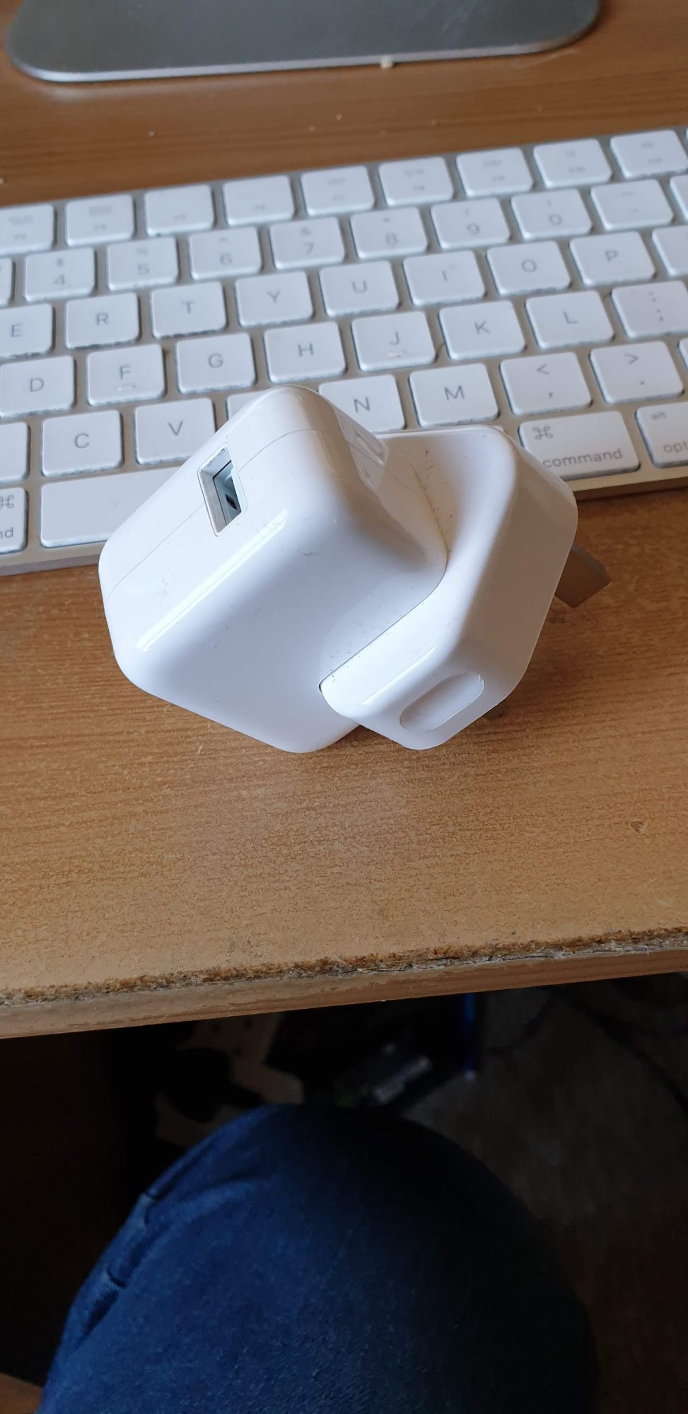

This one is the new one (Black) and the other is i think the original 12w (white) so no wonder that it could be slow 😉

On 12W charger, my 2017 iPad Pro 12.9 took 3 hours to go from ~45% to 100%.

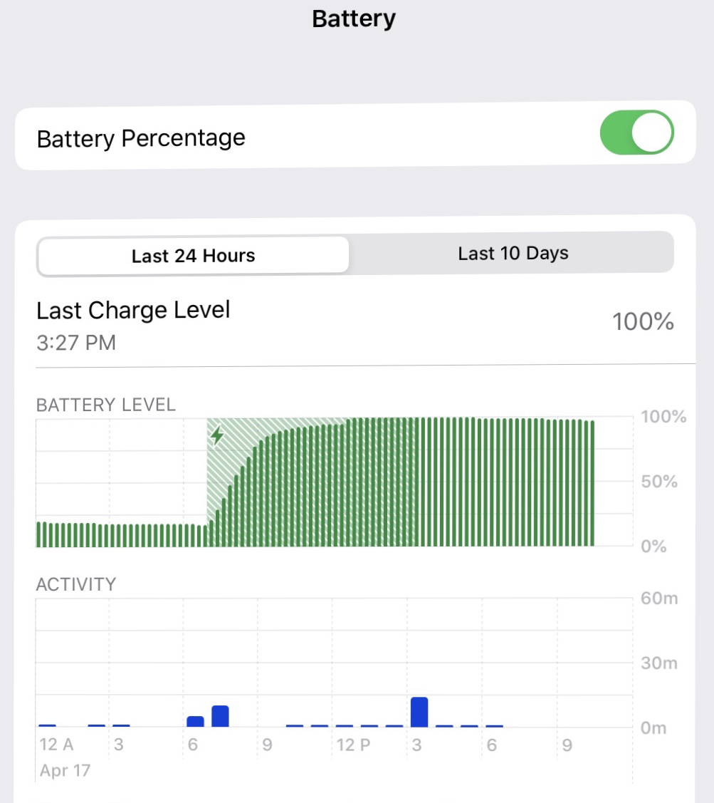

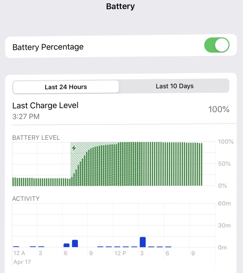

Happened to charge the Pro 10.5 today. Looking at the graph, it took 3 hours to charge from ~20 to ~80% then another 3 hours to go from ~80% to 100%.

With what charger? I am not sure if the iPad Pros have optimized charging by default (similar to iPhones). With my iPhone I have noticed that if it reaches 80 % and thinks that I won't use the phone in the next hours, it stays at 80 % and continues charging afterwards. Is it possible that something similar could happen for iPad Pros?
Anker PowerPort 60W 6-port, max 12W per port.
No optimized charging like iPhones. Just trickle charge past ~80%.
