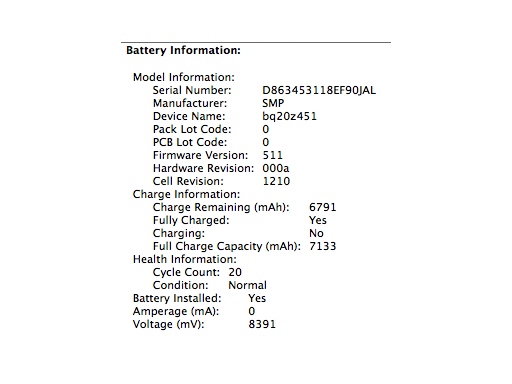

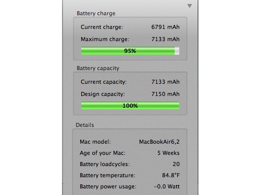

Title says it all. I have had my MBA for 5 weeks. The max charge on the battery is 7133mAh. The battery only charges to 6791 mAh before it indicates that it is at 100% in the status bar and stops charging. When I use coconutBattery it indicates that the battery is charged only to 95%.
What can I do to get it to charge to 100%? Do I need to bring the system to the Genius Bar?

It's normal that your battery may stop charging between 93-99%. For details, read the CHARGING section of the following link.

Run it down to 80-90% and then recharge and you will likely see it get up closer to 100%. It is designed not to fully charge from slight usage at say 96% to prevent overcharging. Your battery seems normal.
