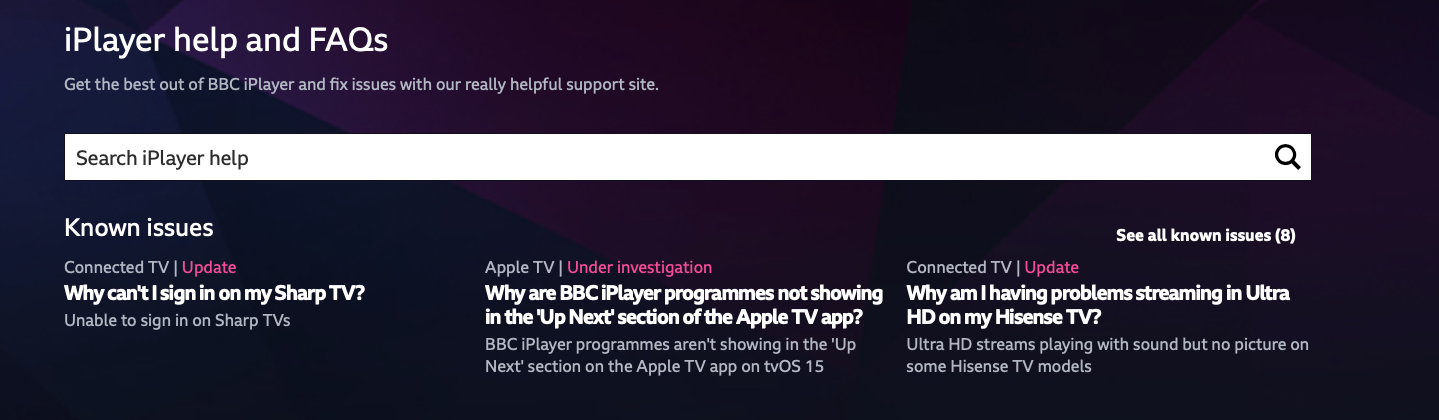

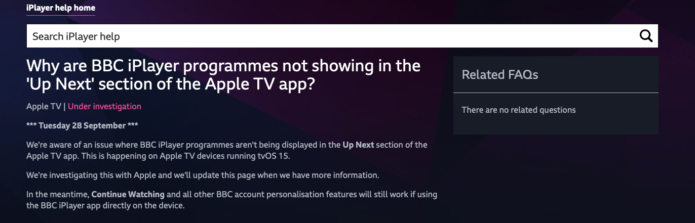

It looks like the BBC are aware of the issue as it's now listed under the Known Issues section of the BBC iPlayer Help Page: https://www.bbc.co.uk/iplayer/help
