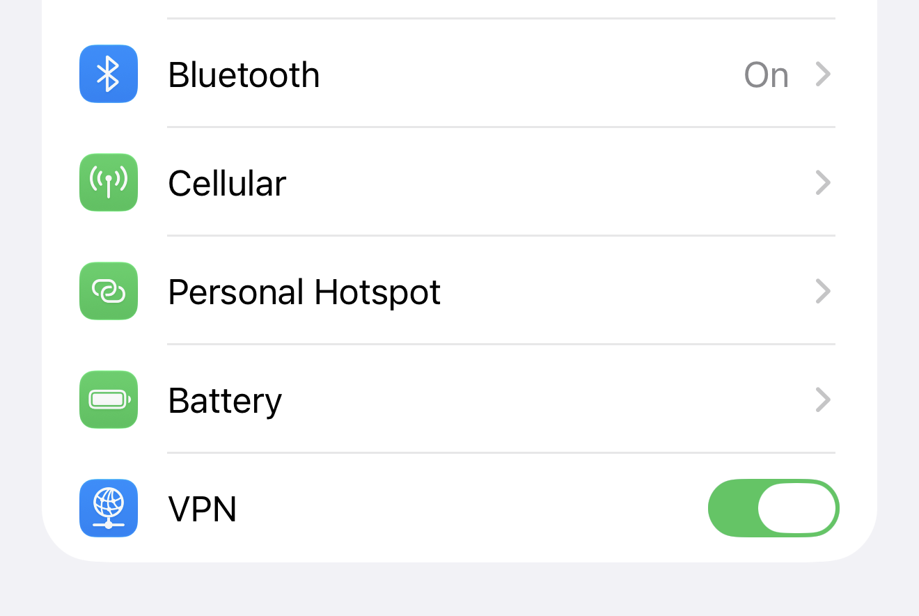

Also I don't have VPN settings - here's what it looks like and why I thought it was odd. VPN used to have an arrow to settings. Maybe because I used to have 2 installed?

Also, VPN config is under General > VPN & Device Management, and only shows an > in Settings top level if 2 are installed.
