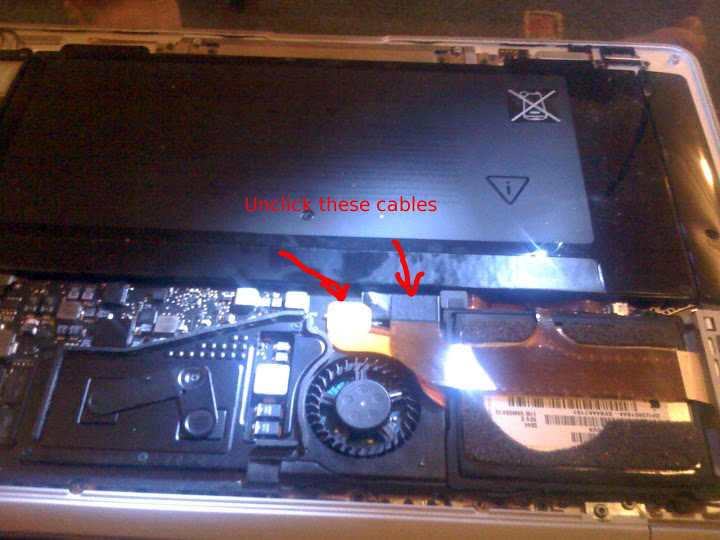

Ayeing, is that pic with the battery removed? I suppose I should have done that when I did my thermal paste application, but didn't think about it at the time.
I ask because it looks totally different from how I remember the inside of my MBA.
Yes, the battery is removed. The picture is something I got from Google Images. I haven't taken apart my air for a few days now.

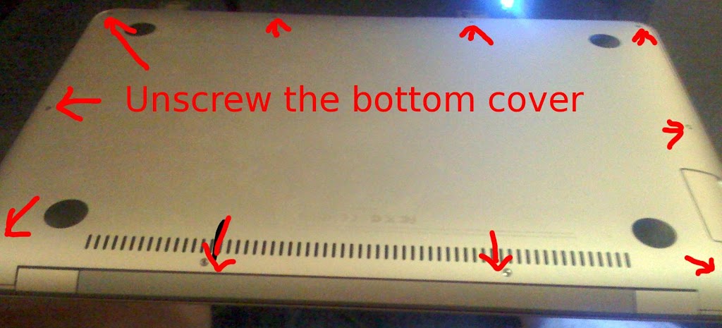

I tried to perform this procedure, but I'm stuck at the step of removing the heatsink. The screws are simply too small. I've gone all the way down to a #000 Phillips and I still cannot unscrew the heatsink.
I have a bad feeling that I may even have damaged the screw heads. Did you have any problem getting the screws undone? I looked at disassembly guides and the screws on their heatsink seems to be larger than mine.
I'm going to hunt for a #0000 Phillips tomorrow. But this whole thing is really getting me down.

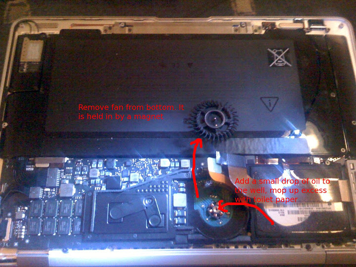

Some pics on oiling the Mac air fan
http://picasaweb.google.com/franssauermann/HowToOilANoisyMacbookAirFan#

Never had any major issues, but had a really really noise fan problem which prompted me to take my air apart this week, I have a rev A so slightly different to the pics above, but the same in practice, oiled that up so now the bloody irritating noise has gone and my Air is back to virtually silent again.
