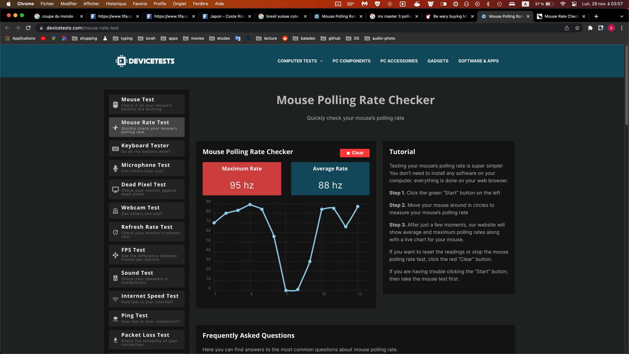

thanks . using BT on my mx master 3 , i get 125hz max, but in reality i don't go over 90hz ,averaging 85-90
with the logi controller (usb ) i do get 120hz , with an average of 115hz
can you show a screenshot of yours ? it looks like mx master 3s has been improved
