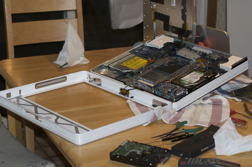

So rather than spend $100 to get the full version of the program I ordered a $55 hard drive and installed it last night. After power up I restored from Time Machine and everything is working perfectly.
Big thanks to Hellhammer for continuing to suggest it might be the HD. I found it hard to believe that a failing HD would cause such slowdowns but never a crash. In the end I eliminated everything else and replaced the HD.
Greg
Photo: After new HD installed. Just have to put it back together.
