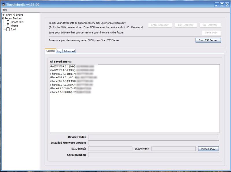

I used TinyUmbrella to save my SHSH Blobs and The WHITE Iphone4 Im on has 4.3.1 and im not sure if im safe..

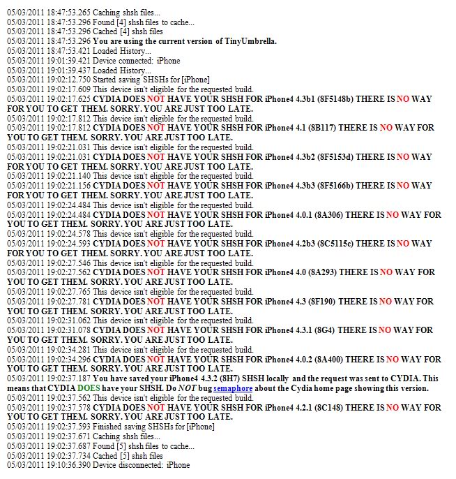

heres some info on the logs from tinyumbrella and i wanted to confirm it with you all to make sure im safe with this plan.. let me know before i get started.. thanks.
pic of log..
Yes. It's correct. Whatever SHSH blobs you can save has nothing to do with what your device is running, but only what Apple is signing / sending out. Right now, it's only 4.3.2 and that's why you can only save that.

I decided to post a screenie so you can get some idea what blobs i have,
