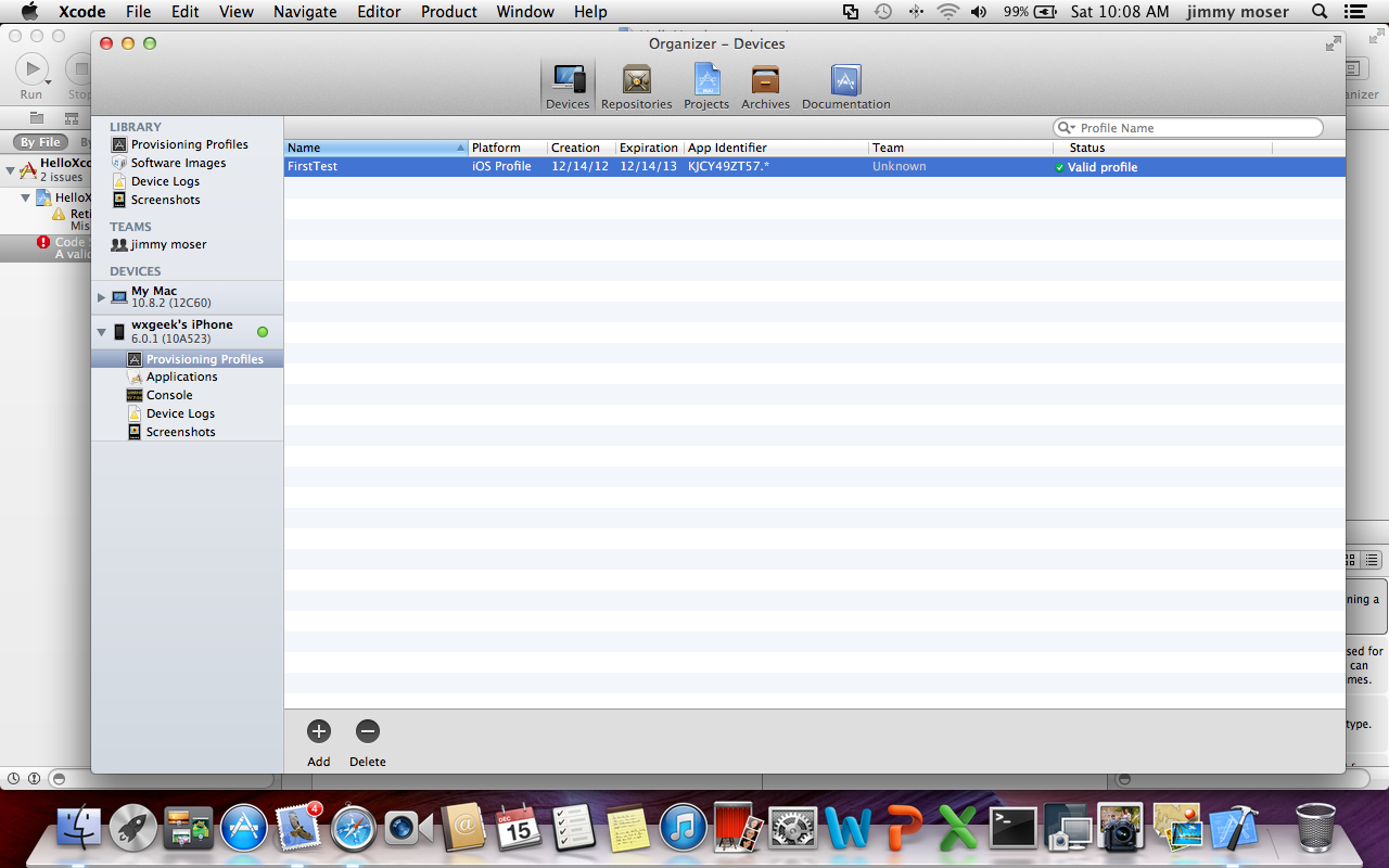

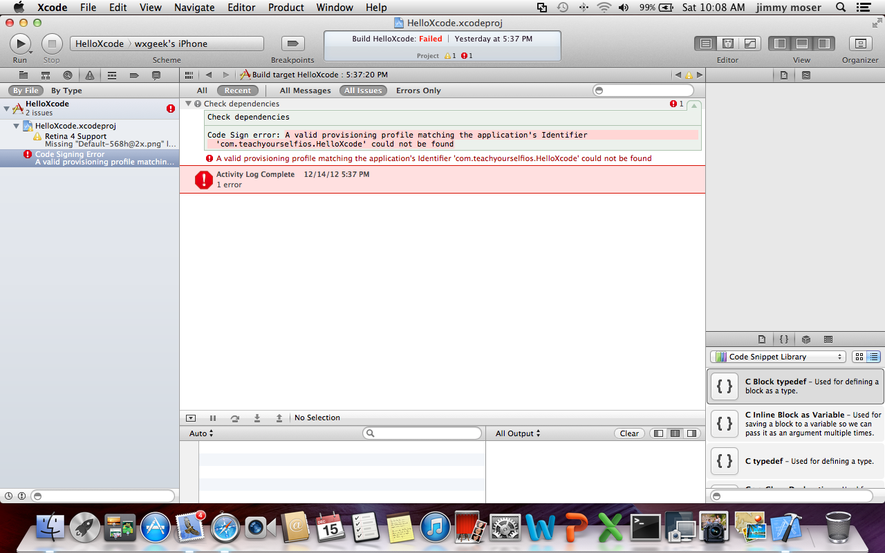

OK...I have the latest Xcode SDK installed on my Macbook Pro. I have updated my Iphone to IOS6. So now I'm trying to set the Iphone so I can run apps that I develop on my Iphone. I went to the IOS Portal and ran the Provisioning Assistant. However, when I build my little hello xcode app it fails becasue xcode says the appid is wrong. I've included 2 screen captures to illustrate the problem.
So my questions are
1) How can I change the current provisioning profile to allow this app to run on my iPhone? The app compiles and runs just fine on the Iphone Simulator.

But on your app target (click on the Xcode project in Xcode on the left, then select your target in the middle & then select "Build Settings" at the top, press Show All right below it, then under Code Identity you can select the correct one.

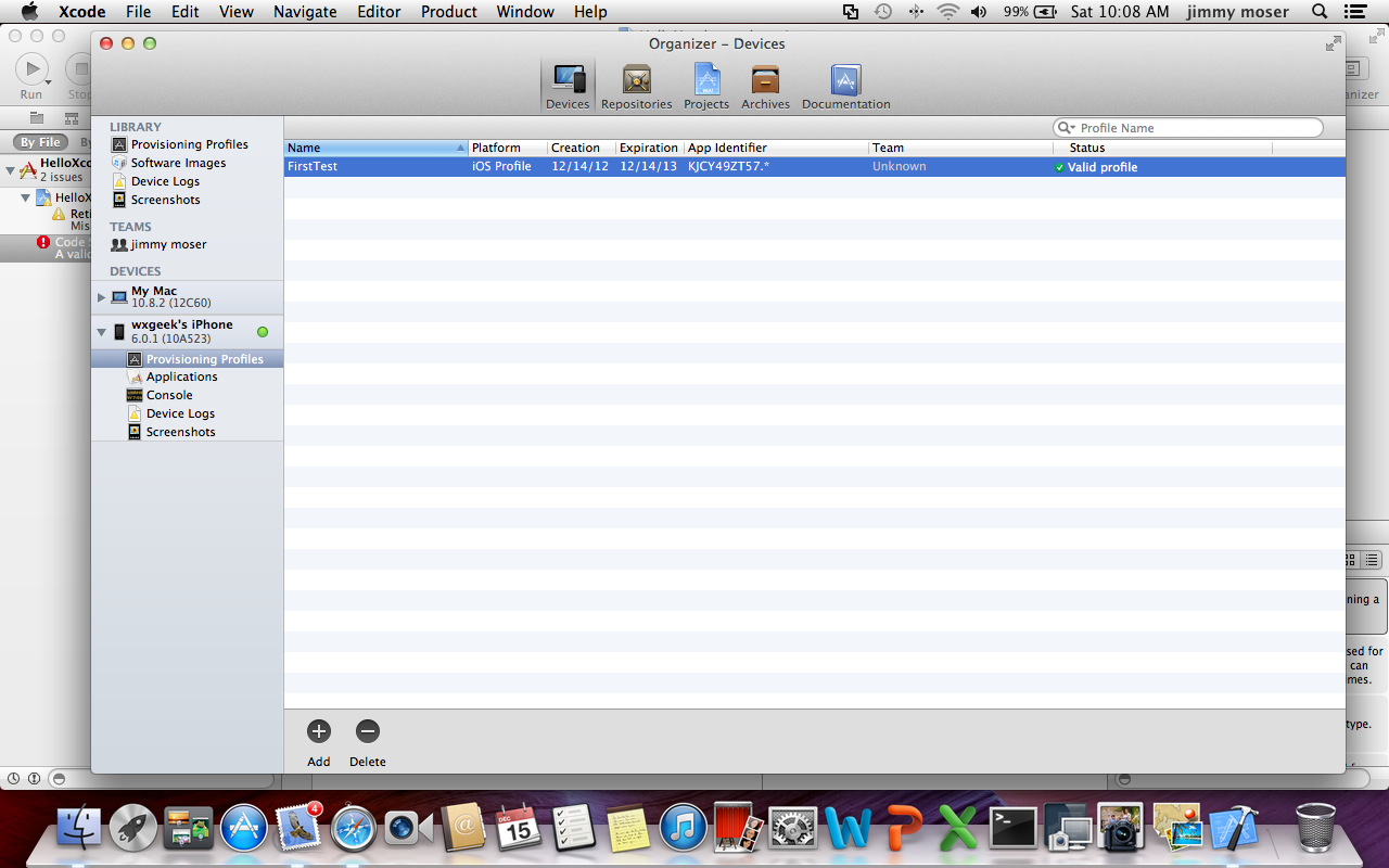

Here are the screen shots.
Also...to cure this problem...I went to the IOS provisioning Portal and generated an AppID that had the correct name and then downloaded that and installed it to Xcode. Don't know if that was the best way but it worked. The app...simple as it is... now runs on my Iphone. (Gotta start somewhere)

You are using a hardcoded one.
You can do, com.yourcompany.* (hence the star), if you type that, you use a wildcard, so you can build any app which starts com.yourcompany (.anyapp) 😉

Do you see an "iOS Team Provisioning Profile" in your Provisioning Portal?
Thanks to all who replied! I took a look at my provisioning profile and it
had a different name than the bundle ID in xcode. So I went into Xcode and changed the bundle identifier to match the appID in the provisioning profile.
That is:
Prov Profile Name AppID
TestingIOS KJCY49ZT57.com.learnIOS.*
In Xcode:
BundleID
com.learnIOS.HelloNoun
Now it compiles and is sent to my iPhone! Yeah!!!
