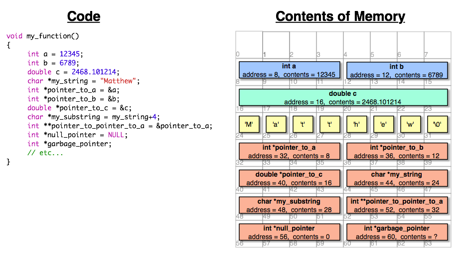

Here's a diagram I often show to people who have difficulty with pointers.
A pointer is basically just an 32-bit (or 64-bit) unsigned integer. However, with a pointer, its numeric value is interpreted as a memory address. So pointers just contain the locations in memory of other variables. That way, instead of passing huge chunks of data back and forth between functions in your code, you can just pass a memory address (a pointer) and operate on the data at that address (dereference the pointer).
The attached file shows a code snippet that declares some variables and some pointers to them. The diagram on the right shows a simplified version of what what the program's memory might look like after the code has executed. Each cell in the grid is one byte. Remember, ints take 4 bytes, doubles take 8, chars take 1, and pointers (regardless of type) take 4 bytes on a 32-bit machine.
Note that the 'type' of a pointer is used to tell the compiler what kind of data is at that memory location. That way, when you dereference a pointer, the computer knows how many bytes to fetch from that memory address. For example, dereferencing an int * will get the contents of the 4 bytes starting at that address, and dereferencing a double * will get the contents of the 8 bytes starting at that address.
Since the value of a pointer is always a number, every pointer points "somewhere." However, an uninitialized pointer might contain garbage, and point to some restricted area of memory; trying to dereference it would likely cause a crash. A NULL pointer has a value of 0 (that is, it points to memory address 0) and is, by convention, used to mean "this pointer points to nothing."
