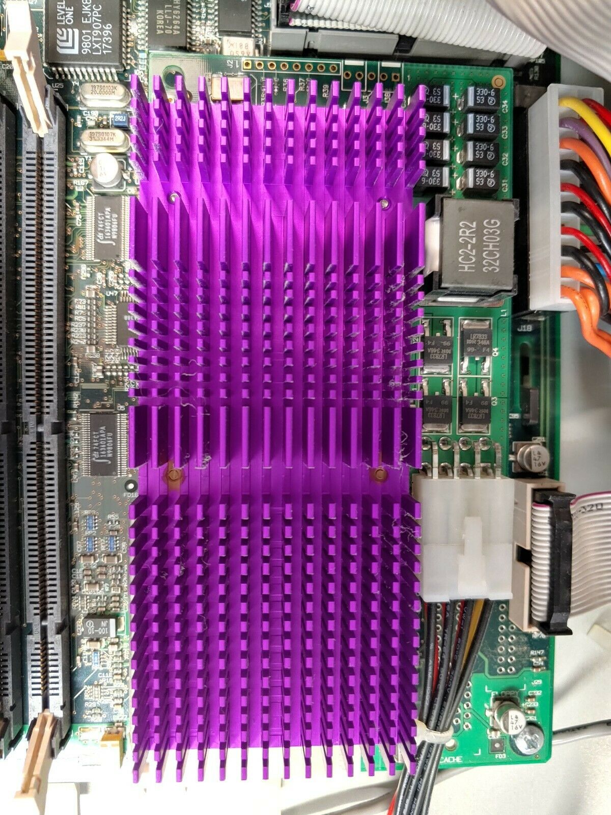

I have 3 G3 towers all work, however this last one i purchased has a unique processor in it. it has a purple sonnet G4 800Mhz processor.

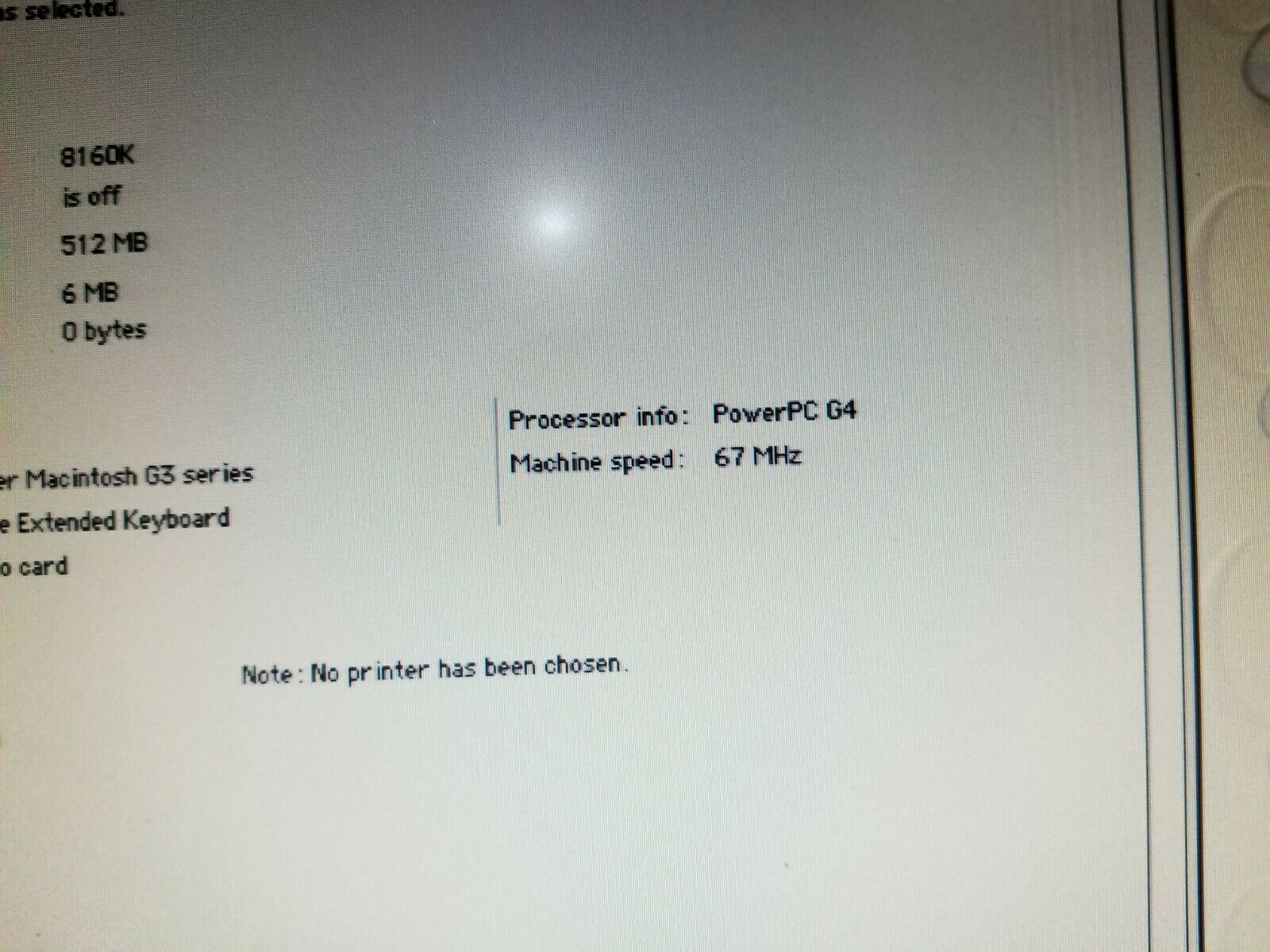

i boot up off cd, 9.2.2 and system profiler shows 67mhz.. also seems sluggish like it really is 67mhz even though its my understanding the
processor is capable of knowing what the jumpers are set at and auto adjust itself to 800mhz , its not the void sticker was still in place
so this was something done by a professional company? at any rate i removed the sticker and the default jumper block is the 300Mhz block
i tried varies jumper settings using my micro jumpers. , no still only 67mhz no matter what i do.
any ideas? It would be really COOL to see this in action.

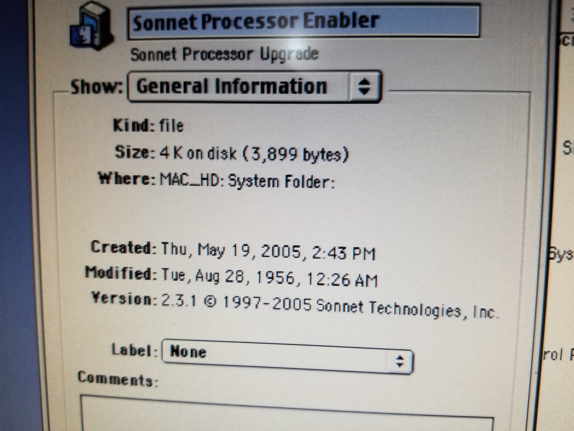

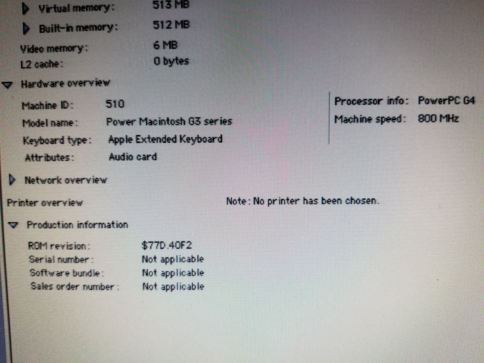

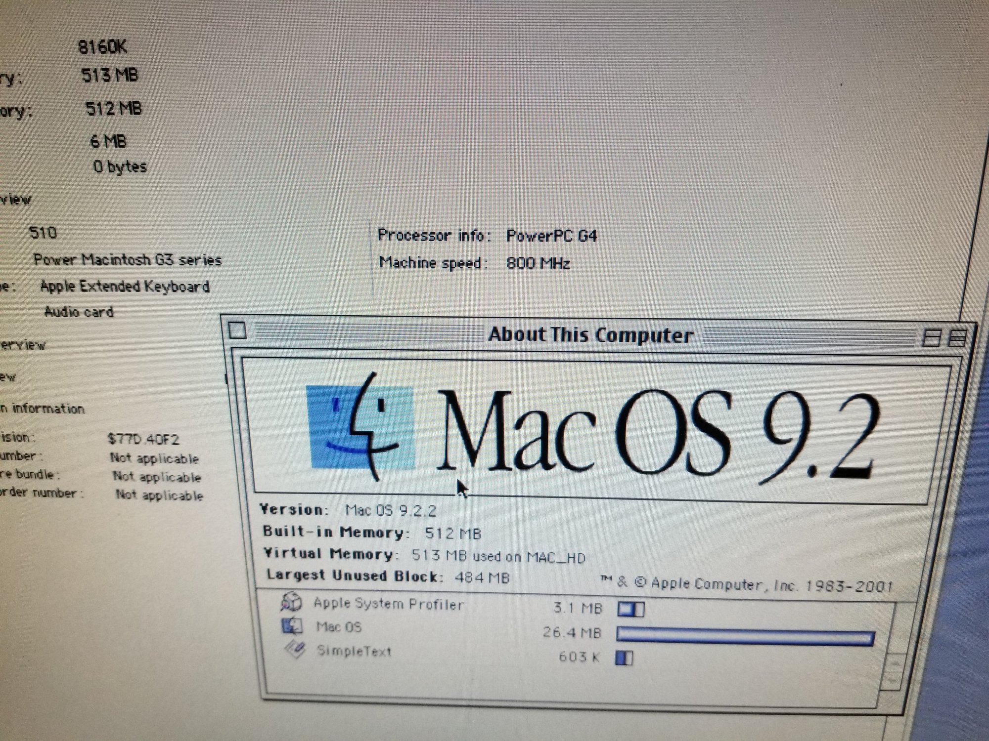

YES SIR! it was the Sonnet_Crescendo-Encore_Driver_2.3.1.hqx that had the Processor Enabler and the Metronome and now runs at 800Mhz !!!
Thank you so much!!!!!!!!!
BTW - installed 9.2.2 from an EMAC recovery CD works great! includes many drivers for ATI / APPLE and NVIDIA 3D cards.
