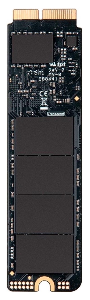

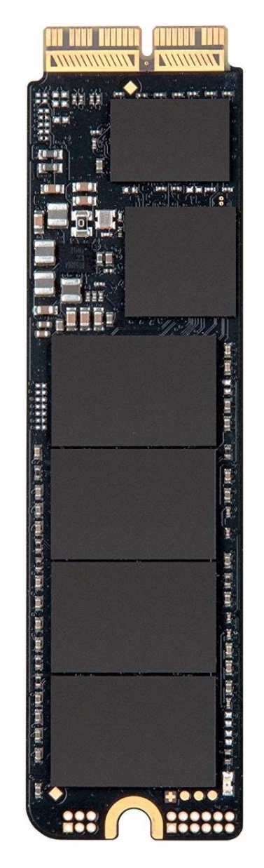

No how do you get that These Transcend Jetdrive SSD the 820 and the 850 only
11 + 15 poles on one side, which is relevant.
See pictures here from the front and back.
I still have an orig. Sandisk SSD, with 128GB from a MacBook 2013 which
has 12 + 16 pins (poles) and which also runs in such a housing see link from Amazon.de
This work with orig. Sandisk from MacBook 2013 NOT with 11+15 Pin Transcend Jetdrive 820
