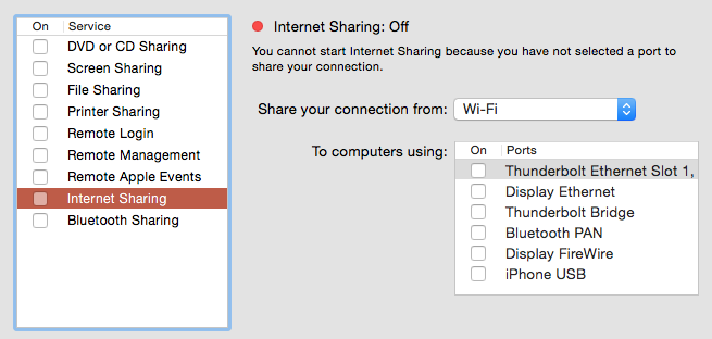

The Mac will share its internet connection but you have to configure it in the sharing preference (system preference) .

Macs do share network connections over any available network interface, including multiple ethernet ports. He just needs to set it up in the Sharing Preferences.
He just needs to turn it on and select Share From ethernet...to the Thunderbolt ethernet port. Here is my system (it's not set up this way, but you can see the options):

You just need to turn on File Sharing. Internet sharing and file sharing are different things. See the picture I posted above.
