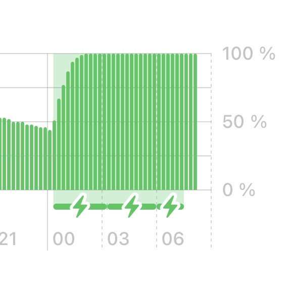

The Belkin is hella expensive but I thought it’d be worth its price. And at first glance it was, it charged my iPhone and Apple Watch over night. I smelled trouble when I randomly looked at my battery settings one day:

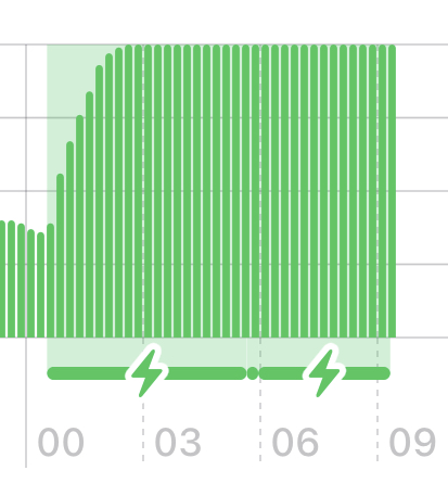

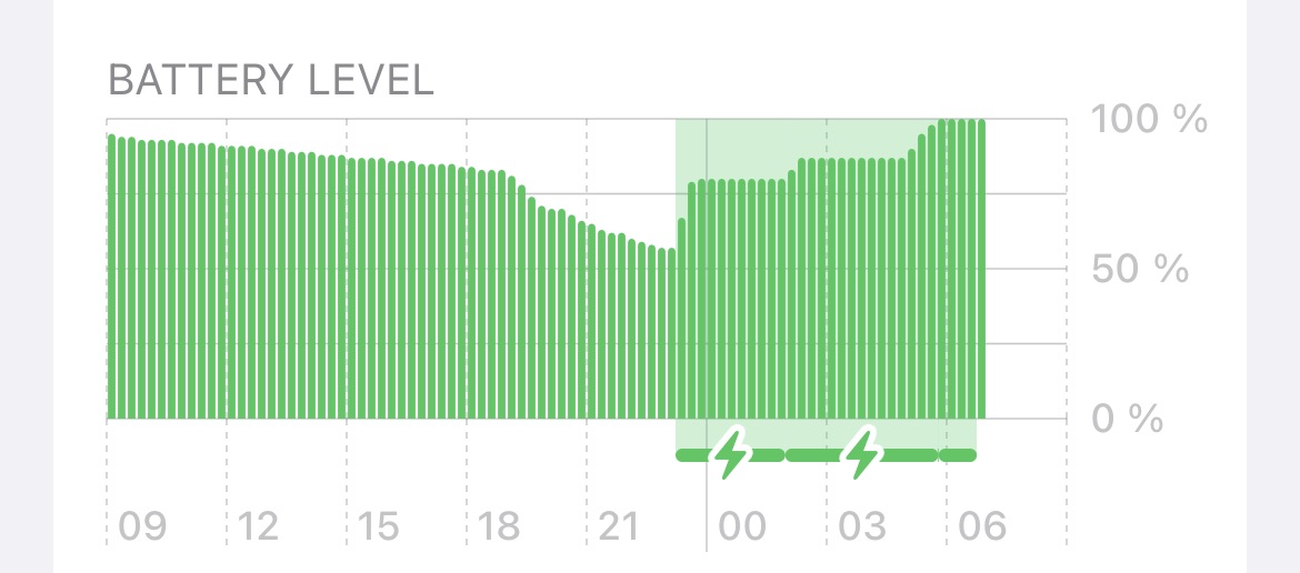

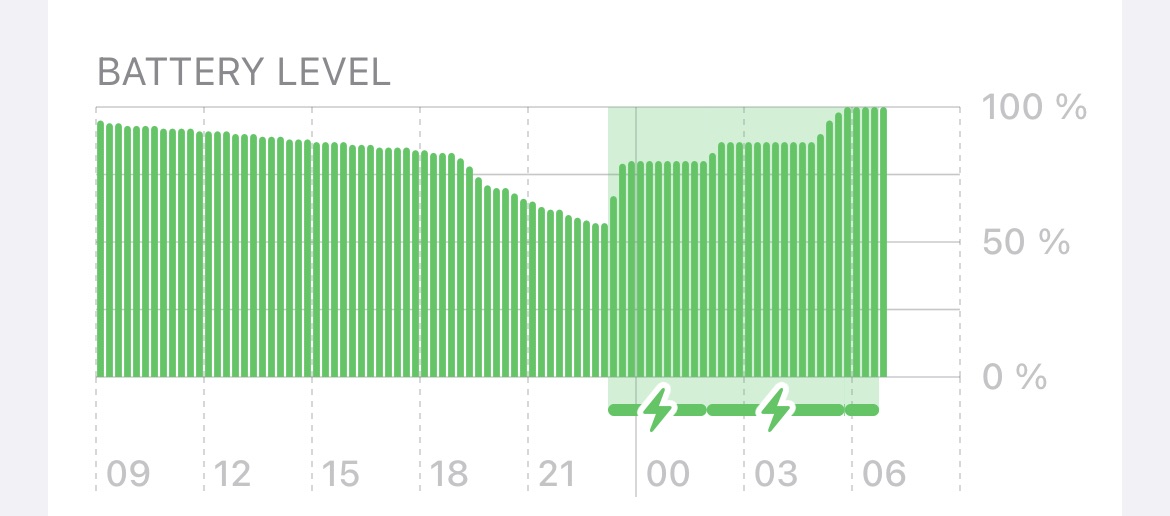

I saw that the charger seems to intermittently stop charging and then immediately start again (look at the lower bar being split at around 6 am twice). I also noticed that the optimized charging feature wasn’t active. I initially put it off as a one-off hiccup or that we may have had a power outage or whatever, but this issue came up every night to varying degrees. Sometimes it would stop charging only once or not at all, but most often it would be 3 times or more, and at completely different times. Another example:

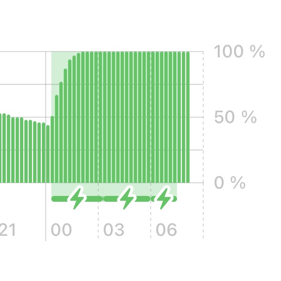

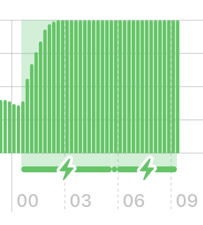

I assumed it was a faulty unit or power adapter so I contacted Belkin, explained my issue with it and had them repair/exchange it. That took forever and only after me asking about it they sent it back, without explaining what they did (repair, exchange, nothing). It seemed brand new. So I started using the unit they sent back, the first day it was good, the second day:
I had started using my old $15 Anker unit again ever since I had sent the faulty 3-in-1 back to Belkin. The Anker worked perfectly, the wobbling notwithstanding. The bad thing about this is that this issue breaks optimized charging on the iPhone and also the Apple Watch (the power drops also affect the watch according to its own battery settings), because the phone thinks I’m disconnecting it before it’s fully charged up.

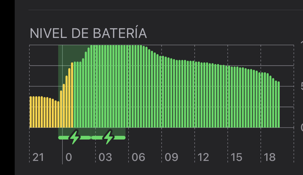

ive had one for a while now and havent noticed anything. my optimized battery never works though but that could be that i never charge my phone with a set schedule and it always changes when i charge my phone. i don't have a way to find out if it cuts out though. i have the other variant though the stand version that suspends the phone up so that could be it, did not know belkin had 2 different ones. this is what i have Boost charge pro

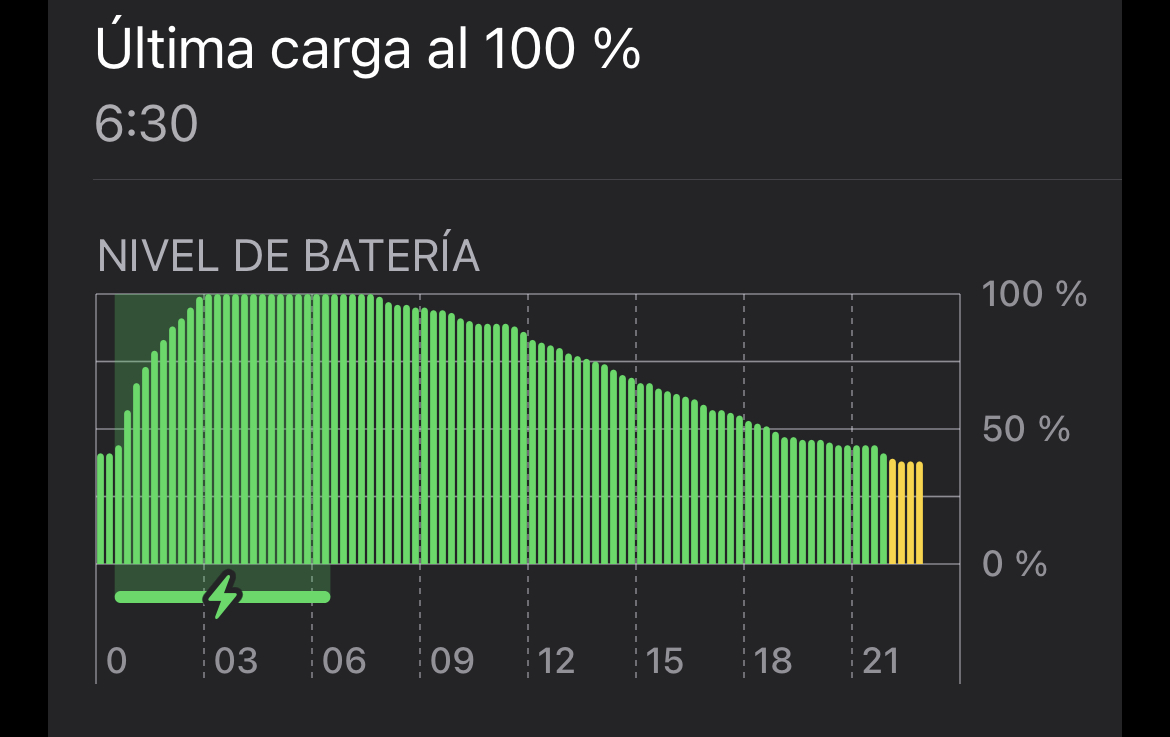

Since I read your post, I have been checking the charge of my iPhone 13 on the "Boost Charge Pro 3-in-1 Wireless Charging" charging base for several days and the charge as you can see on the graph is correct, without microcharges, I leave it as you see it all night charging and without problem. I don't know what the problem may be if the two bases you've had are defective, but I have the same base and it works correctly for me. Bye

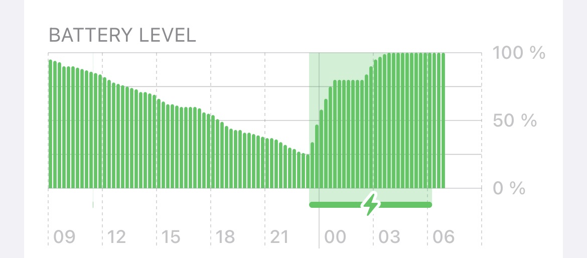

Tonight I noticed that the charger has made two charges, I think and I suppose that it is because of the optimized charge it will have charged up to 80%, then it is still connected to the network without charging and then it will be recharged up to 100%

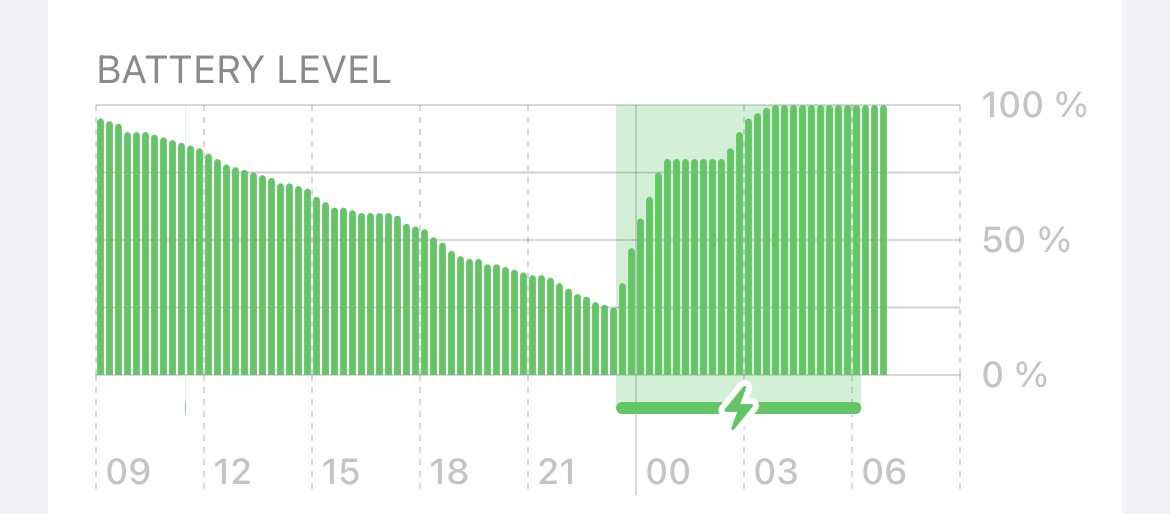

Just to clarify: With optimized charging the only thing changing about the graph is that it stays at 80% for a while. The bar at the bottom will be continuous and not split (as you can see in the last picture in my original post).

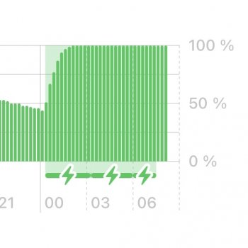

Mine has no dropouts but seems to be very slow. It took almost 5h to charge my iPhone 13 pro Max from 18% to 100%.
I took it from the charger at around 4AM and used it for about 15min that`s why there is a dropout.
I just bought mine 4 Weeks ago. Maybe they changed something internally and now instead of dropouts it is very slow.
