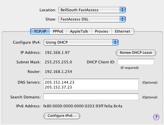

That sounds right up to the PPPoE and re-dial, but if they have no idea was Mac OS X is, you should be talking to another support person.
I'm including my settings, but the router in my case is the Westell DSL modem, which is handing out addresses and is connected directly to my Ethernet switch.
They apparently sent you the wrong setup utility, as mine worked natively.

Powerbook G5 said:
Do you need those DNS servers entered in?
Probably not but I added the DNS addresses recently because it spends too much time lately looking for address translations. I spent a long time without them but this is the first ISP which didn't give me any to add.
