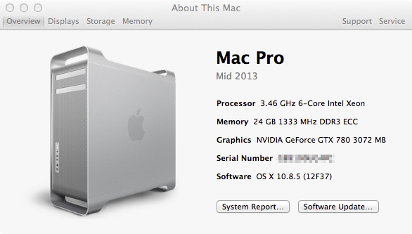

The 780GTX uses about the same power as a 570GTX. I'm running it off motherboard power with no issues. The GPUs are -not- underclocked. Only the Titan needs external power. I imagine if you overclocked the 780GTX, it would as well, but at stock speeds with turbo boost 2.0 locked at 80C, it's fine.

Granted the extra 8-pin power connector is surely useful/necessary for overclocking, which all of these cards are capable of from the factory, maybe it's not ultimately necessary for a stock-clocked 780GTX? Dave was pretty adamant about not wanting to OC the 780 as it was "fast enough", and that the limit lay somewhere in-between the GTX 780 and the Titan.
Dave can speak for himself eventually, since he's modding the second 8-pin connector on the card to work with a 6-pin connector via solder. For now, I'm just enjoying my card, and I've not had it blink off or behave strangely at all.
