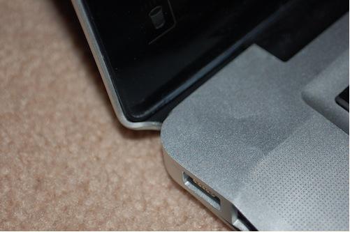

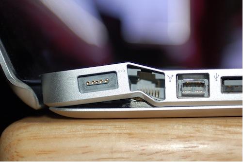

Anyone have any suggestions on how I could possibly bend this back without harming anything. I was thinking about using a G clamp and put peices of wood in between the laptop and the clamp and slowly tighten to bend it slightly back. I was just worried about messing up the charger port. Everything still works fine on the laptop. I just thought yall may have some suggestions.
Thanks

:eek::eek::eek: I would say that is about the only thing you could do. Just be careful with the bottom of the case side, it looks a lot more bent than the top. You wouldn't want to crumple it any more. Maybe push it gently to re-straighten it as you are tightening the clamp.
My gods, that photo makes me wince!
How in the heck did that happen anyway? o_O I want to make sure it never happens to mine!
Did it get stuck in a car door or something? That's wild... I hope you can fix it.
I`m curious as to what happened too, call it morbid curiosity...
The G clamp idea might work but you`d have to be really careful/gentle with it.
The ethernet port always bites the bullet in any impact on that side, the alu is just so thin there.

Personally, I would first disassemble the computer so I could get at the case alone. Then you could try the block of wood as you suggested. Although I would also invest in a small hard plastic mallet to minimize in scarring of the case and use the wood block as bracing behind where you strike to help shape the metal and avoid damage to the lip. You could also use a lead hammer but you don't really need that much weight for thin aluminum.
A mallet such as this. Not the large rubber type.
You may also need to use pliers for the kink on the short metal strip under the Ethernet port hole. When gripping I would at least place a towel in between the teeth of the pliers a rubber sheet would be better. To minimize impressions the steel will make in the aluminum.
As for the Magsafe port. I think the port is separate from the motherboard and attached by a short cable so you should be safe there.
I've done this a couple of times for people. Since it is much cheaper than buying a new case.
Edit: It looks like you will also have to disassemble the screen. So it will close properly. I would not try anything with the LCD installed. It would be too easy to crack the screen while hammering or bending.
