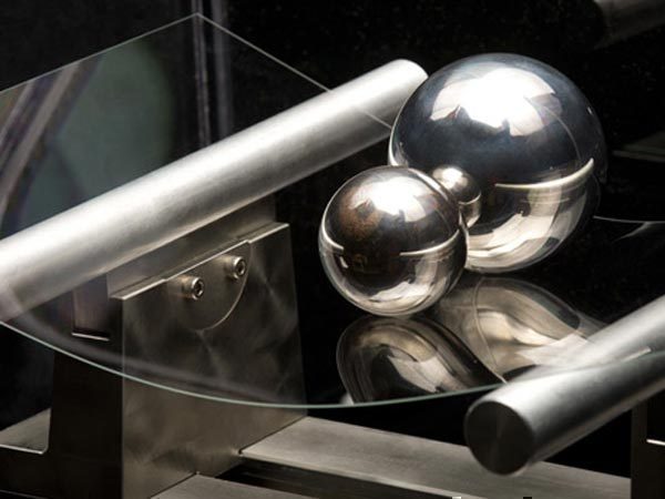

There have now been a number of threads with people having bent iPhones. It's kind of hard to understand why every single one of them would be lying about someone physically sitting on their phones. It just makes little sense for them to all withhold this information because none of us have any say in Apple replacing their phones.
I would also expect the screen to break too. About the picture above (the weights on the glass), we don't know how slowly those weights were added onto the glass. Someone sitting on the phone would cause a sudden shift in weight (of likely over 100 lbs) directly onto the glass face, not unlike a sudden fall onto a hard surface, likely causing the glass to shatter. Plus, we do not know how the other components of the screen affect the resilency of the Gorilla Glass either.
I don't know why many people state that their phones have bent without the benefit of their rear end applying pressure - but many of the ones I have read often are written in a way that feel (to me at least) as they are prepping their story for the Genius Bar - getting a feel from responses at MacRumors whether the guy at Apple is going to laugh them out of the room or not - I look closely at my 5 and can see pretty clearly that it is damned thin and would not take a great deal of pressure to bend - but to spontaneously bend with no outside force seems difficult to believe (for me) -
No. Because Aluminum is more rigid than the glass, the aluminum frame will fracture first.
