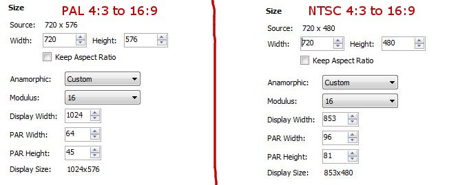

You should really have started a new thread, but here you go.......
Select custom anamorphic, turn off "keep aspect ratio", make sure width and height are the same as your source(720x576 for PAL DVD or 720x480 for NTSC DVD) and then:-
If the DVD is PAL(720x576) set PAR width to 64 and PAR height to 45 which should give a display size of 1024x576.
or
If the DVD is NTSC(720x480) set PAR width to 96 and PAR height to 81 which should give a display size of 853x480.

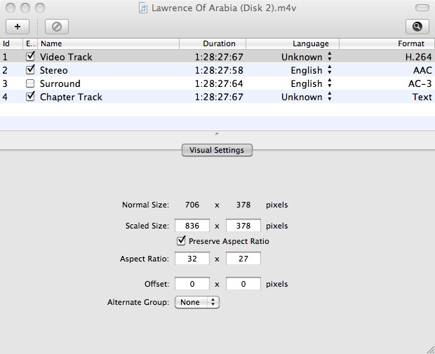

Not sure if Subler will work in your situation but it is pretty handy. Just open the file in Subler and select the Video track. That will open controls for the aspect ratio. Adjust as needed...
