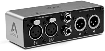

Also note that the Duet (which is what you're looking at I think) will operate without external power (USB bus-powered). It can also work with your iPhone or non-pro iPad. The other cool advantage is you can get one of these docks and you can quickly hook up everything in your studio to the Duet by connecting one cable. They don't officially make these any more, but you can still find them on eBay etc. These are all benefits if your recording set-up is mobile. If everything is going to permanently sit in one room, then these points don't matter as much.

Is there a name for this dock? Searched eBay for "Apogee Dock" and Apogee XLR" and didn't see anything.

I'm on the fence on the horse tail I/O splays, but it is nice having multiple splays already connected and simply hooking up one cable. I've seen these being a huge problem with the Apogee One, but I haven't seen too many problems with Duets so far (maybe thicker cables).
The dock is officially called a " Duet breakout box".
