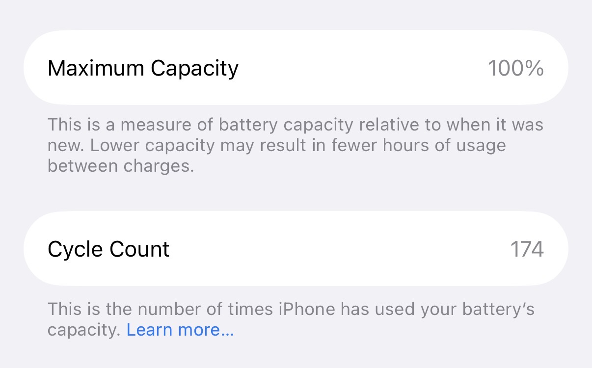

I've actually been charging with a mix of 40W at home, and the older 20W one at work. As you can see it hasn't yet impacted my battery health. I'd say go for 40W, especially if there are times when you forget to charge, and have to rush out somewhere, or you want to be able to fast charge an iPad (I think the newer iPads take around 45W). Devices only seem to demand higher wattage year on year as well, and most take north of 30W these days; given that this charger will probably last at least a decade, I'd get the future proof option.
