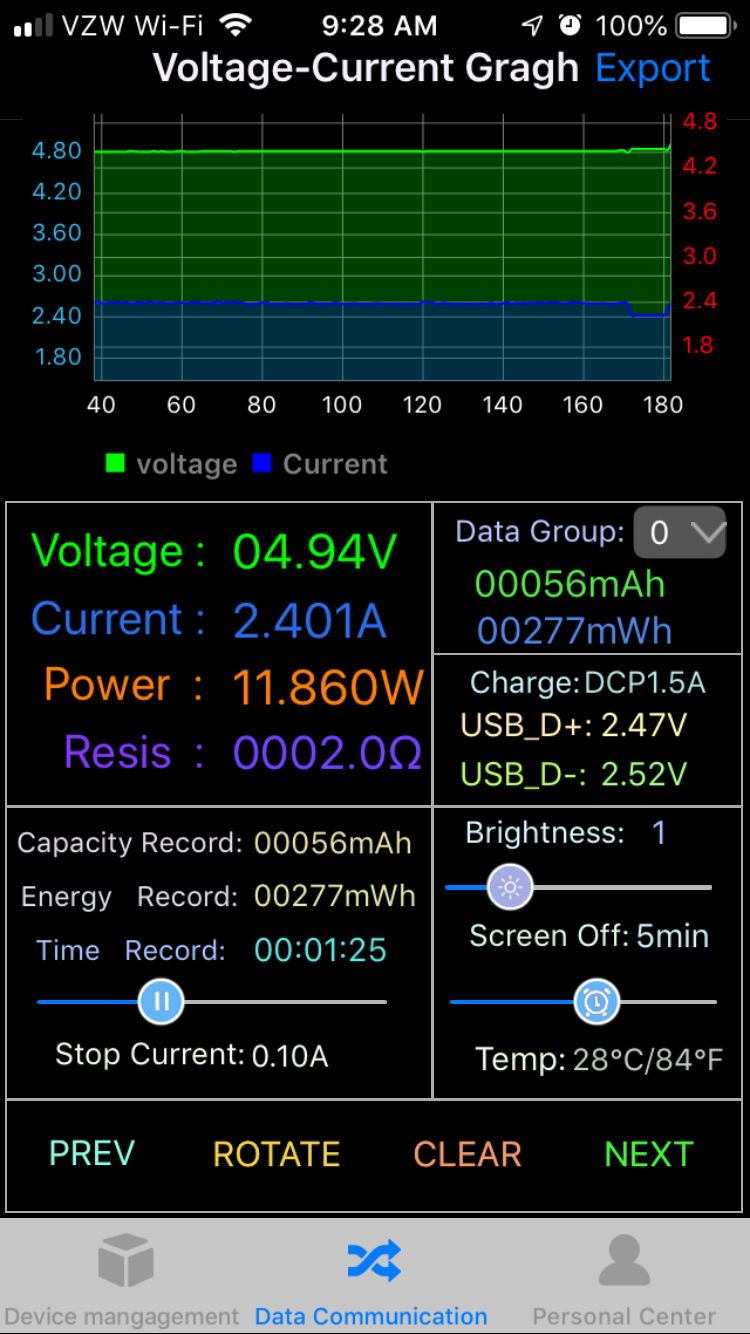

Any MFi cable is required to meet the specs Apple has determined, the main spec being 2.4amp @ 5volt. The problem is determining if the cable is really MFi certified or not. Note how this cable doesn't say MFi certified and they advertise 2.1 amp.
https://support.apple.com/en-us/HT204566
Anker (or any name brand) MFi cable is a good choice because they wouldn't be able to falsely claim MFi certification for very long. AmazonBasic cables are also MFi certified and I've had very good luck with them although not as durable as the Anker cables.
iPad charging 2.4amp @ 5volt which is as fast as it will charge using an AmazonBasic 3 ft cable.

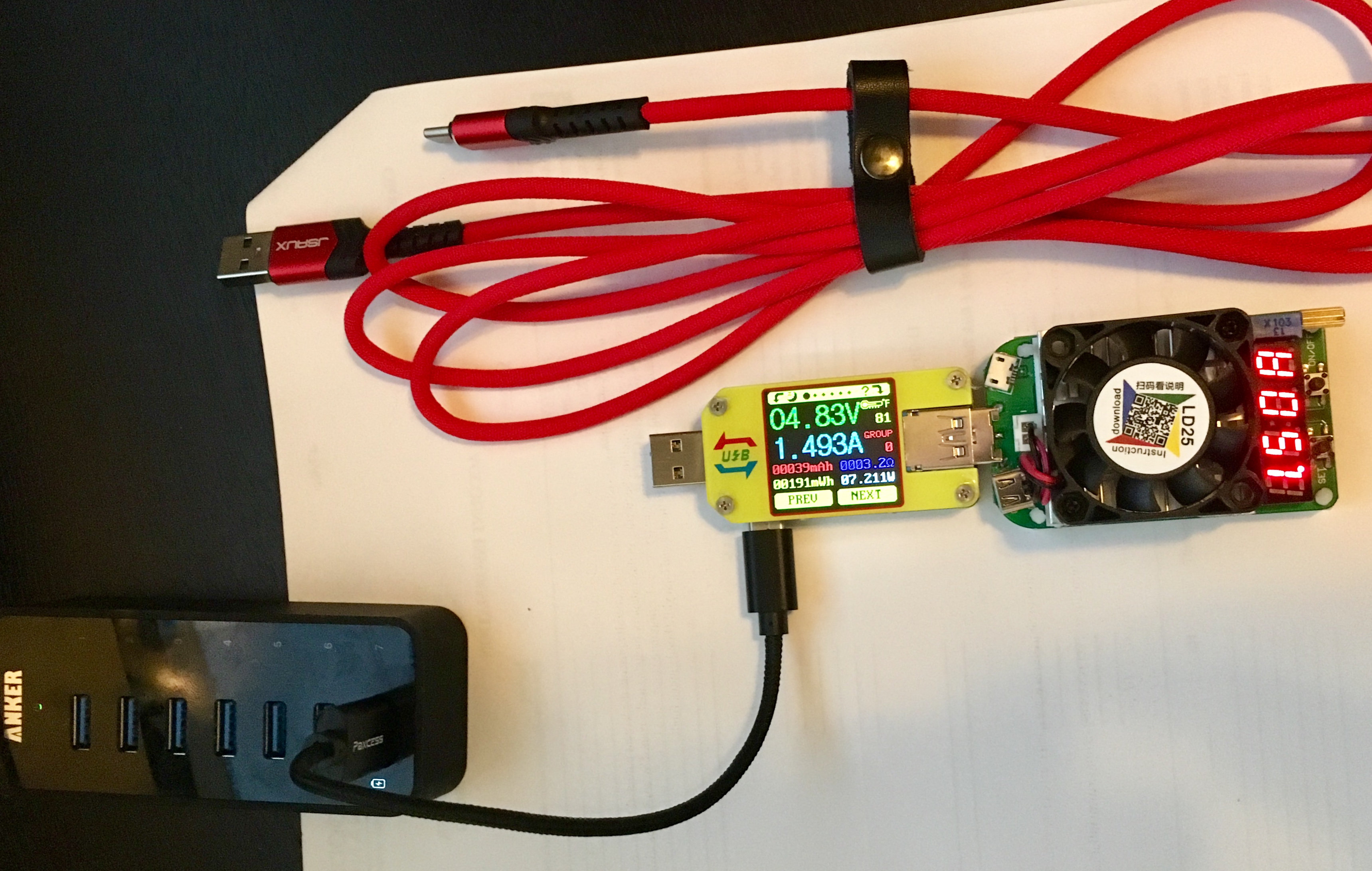

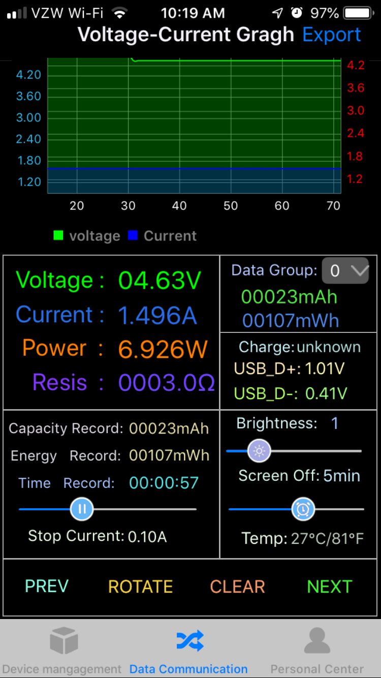

Using this hodgepodge setup of a UM34C USB tester with a LM25(?) simulated load to test a cheap 6 inch USB A to USB C cable vs a higher quality 6 foot USB A to USB C cable.
Having the load set to 1.5amp.

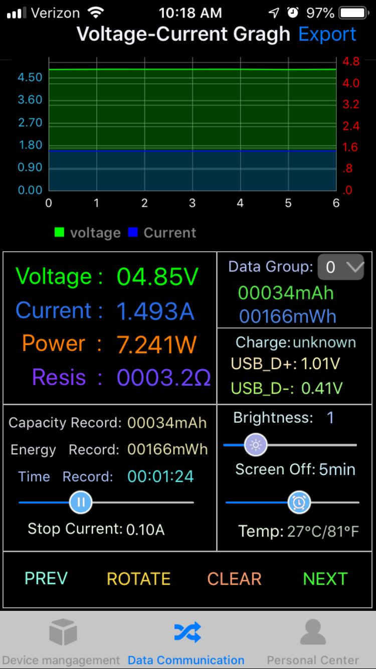

The 6 inch cable...
7.24 watt

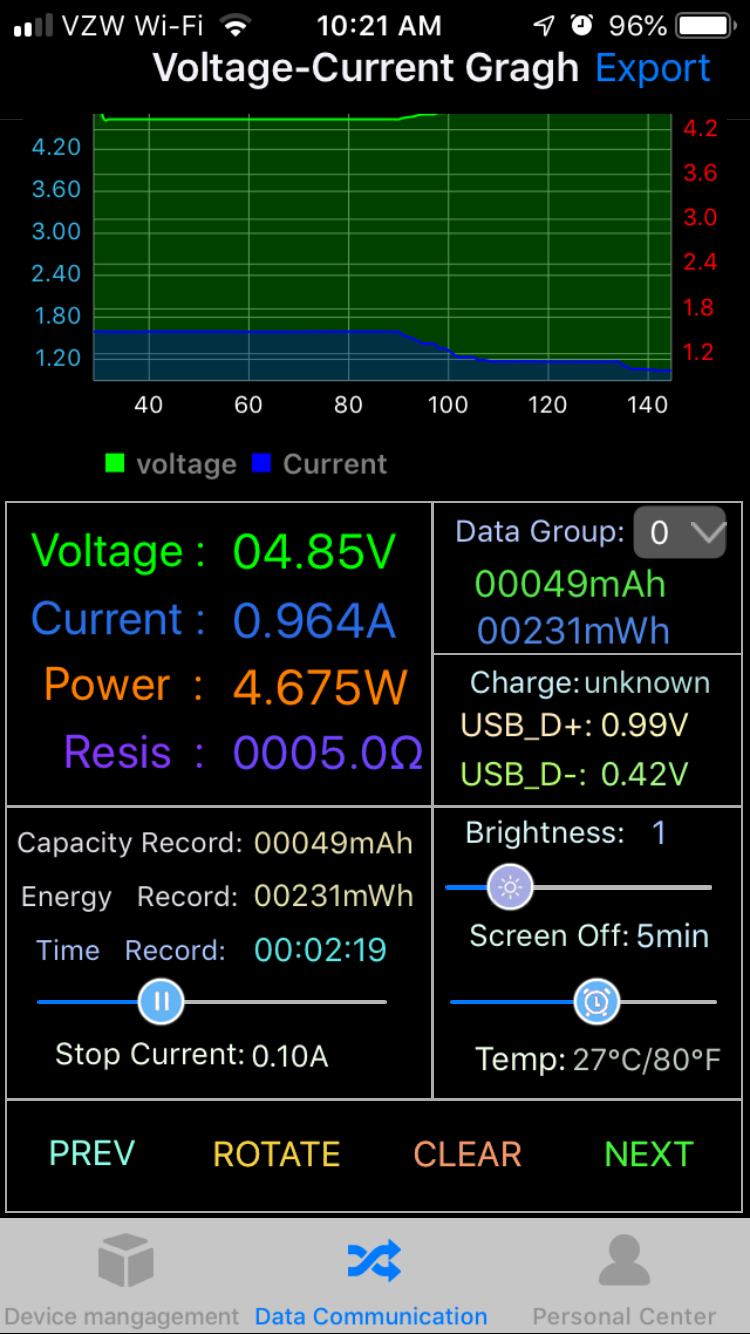

The 6 foot cable
6.92 watt
Reducing the load to increase the voltage back to 4.85vdc with the 6 foot cable.
4.67 watt
Needless to say getting needless long Lightning cables is not only more expensive but will typically have less performance.
