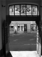

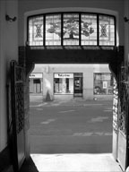

This is a quick comparison of two methods mentioned here. The one on the right is from the LAB conversion and the one on the left is a straight Greyscale conversion. The LAB conversion has better "out of the box" midtones. I think.
The original was RGB color space.
