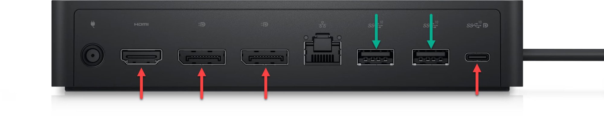

further question: does anybody know what the ports on the back of the DELL UD22 are for?
there seem to be two x USB3 (traditional full size) and one USBC thunderbolt.
I tried using them, and it seemed like it blanked out the whole unit, not sure what happened.

PS: I am still not sure what to do with the ports on the back of the UD22 - any suggestions? (I know I'm leaving myself open for a wisecrack!)
The ports marked in red are where your monitors should be plugged in. It can be any combination of the ports in red. The green USB ports are the same as the 2 USB ports at the front. They are additional ports for USB accessories.

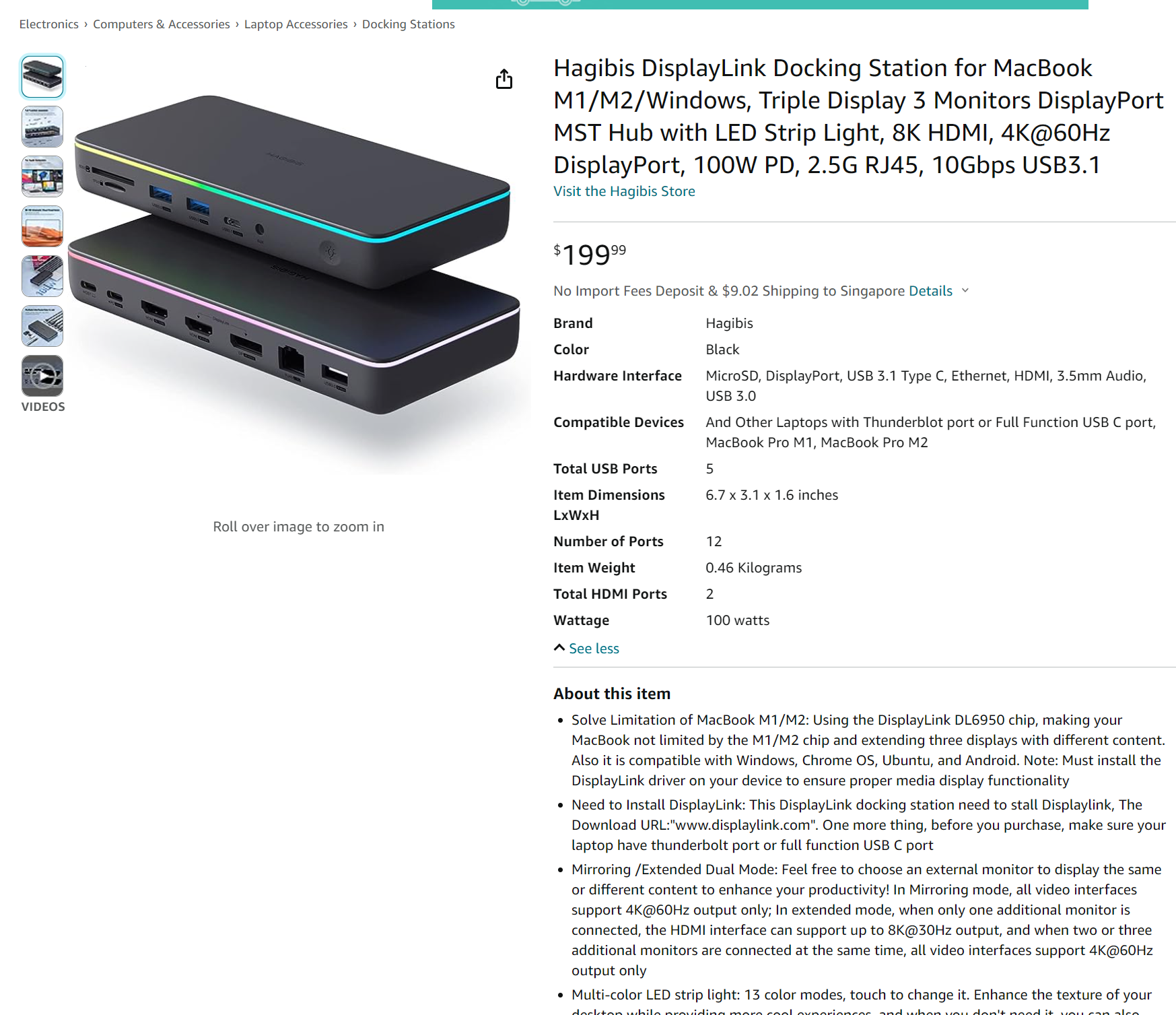

Glad to find this. At post six month, I use an orico dock which also base on displaylink but only support two extended 4k60 monitor.Btw, the third extend monitor of UD22 must use usbc2DP cable?(I remeber it support 4 extended monitor, seems only 3 for m1?)... I'm hesitating to buy UD22 or CD100 now (it's displaylink support 3 extended monitor originally).
Glad to find this. At post six month, I use a orico dock which also base on displaylink but only support two extended 4k60 monitor.Btw, the third extend monitor must use usbc2DP port?(I remeber it support 4 extended monitor, seems only 3 for m1)... I'm hesitating to buy UD22 or CD100 now (it's displaylink support 3 extended monitor originally).View attachment 2243248
That Hagibis dock only supports 3 external monitors. The USB-C port doesn't seem to support video.
It's best to buy Dell as they provide firmware updates. These docks are mini computers and need updates once in a while. Other manufacturers may not have any after sales support.
