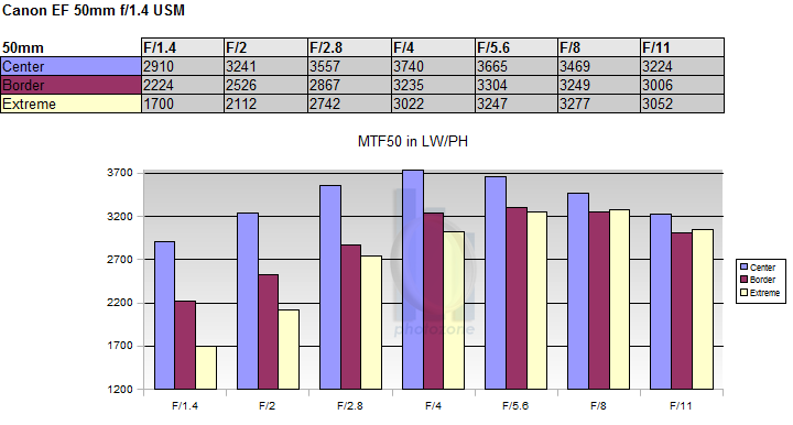

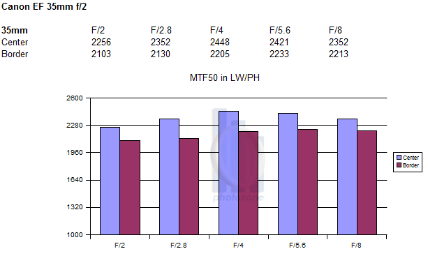

    I see what you are saying, but a lens like the 17-55 f2.8 gives you a very good portrait range of focal lengths including the most popular on a crop (35mm and 50mm) all at very good sharpness, even wide open at f2.8...
    17-55 f2.8 at 35mm and 55mm
    [​IMG]
    Here are the charts for the 35f2 and 55f1.4...
    [​IMG]
    [​IMG]
    Both primes need to be stopped down to f2.8 to match the zoom and even then, the difference is not that significant... is that slightly increased sharpness really all that appreciated in a portrait, and worth the hassle of constantly having to switch lenses all the time or the loss of flexibility you get with other focal lengths on the zoom?
    From a technical/sharpness point of view, I'm just not buying the argument that non-L primes are better than a zoom... they aren't. Perhaps there's a creative element that I'm still missing?

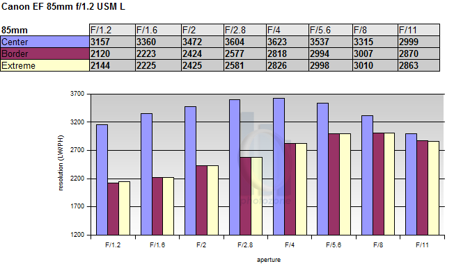

    First off, neither of the two lenses you mentioned (35/2 and 50/1.4) are what I'd call "sharp" wide open, and I wouldn't use either as portrait lenses. If this is what you're comparing with, then yes, I would go with the 17-55.
    Try the Canon 35/1.4, Sigma 50/1.4 and 85/1.4, Canon 85/1.2, and Canon 135/2; these are the real sharpness stars.
    [​IMG]
    [​IMG]
    It's not a hassle at all; I carry two bodies, one with a wide prime and one with a short telephoto prime, and I move where I want to be to get the framing and perspective I need.
    And it goes without saying that all of these primes are better at f/2 or lower than your zoom is. They also work much better on FF bodies. ;)
    Nothing wrong with zooms; I prefer primes, for the sharpness, the shallow DOF, and overall IQ. But I also see a 17-40 f/4L, a 24-70 f/2.8L, and a 70-200 f/2.8L IS in my bag. Horses for courses.

    You are comparing an APS-C lens on an APS-C sensor to full frame lenses on an APS-C sensor and that is completely flawed in the first place.
    No, actually, they don't.
    [​IMG]
    [​IMG]
    Both EF 35mm f/2 and EF 50mm f/1.4 USM resolve more than the EF-S 17-55mm f/2.8 IS USM, all wide open. In fact, the EF-S lens never catches up, ever, against either lens. Not to mention it will also never go below f/2.8.
    You are not using the full scope of an EF lens on an APS-C sensor. It's a flawed comparison.
    As it has been mentioned by others , it is not just the resolution advantage for fixed lenses but also the depth-of-field control and speed advantage that you do not get with a zoom lens.
    My $75 EF 50mm f/1.8 II resolves better than my $1,299 EF 24-105 f/4 L IS USM.
    Fixed lenses do one thing and they do it well. Most of the time anyway.
    I'm sorry you think that way but it's a simple fact that most regular EF fixed lenses will outresolve EF zooms, L or not.
