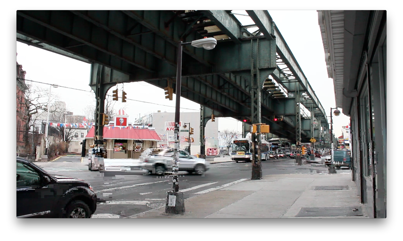

So I bought a T3i a while ago to shoot video projects with and was having some trouble with the footage I got off it (I made another post earlier; thanks for your help narrowing my problem down). It now looks like the problem is my external hard drive. It's a 1TB MyBook Studio with a FireWire 800 connection that I bought about two years ago and has served me well for editing up to this point. It looks like the files from the T3i are too much for it to handle, and when I import them to the drive some end up with corruptions like in the attached screenshot. Importing them to my desktop works fine, but the SSD in my laptop is small and not a realistic storage option.

Maybe "compression artifacts" isn't the right term since they show up before I transcode-- some of the H.264 files I dump on the drive will play back with pixellation and glitches like in the screenshot I included in the original post. This happens as soon as I put the files on the external drive, so backing the original files up there doesn't seem to be a good option.

So like one other person said, it's more likely, your card that you record to. It's either not fast enough to handle footage consistently or there's data corruption in which it needs to be formatted or replaced. Get cards that will have a throughput of 40MB/sec or higher.
The only way you'd see such artifacts like the one I see on your screenshot is if the camera is not recording properly. At least that's what I've experienced and I've been doing videography/cinematography for quite a bit of time. Though I'm totally open to being wrong.
Yeah, I felt like the card was the most likely culprit too, so I bought a brand-new Extreme Pro SD card with a 95 MB/sec rate. The very first footage I shot with it exhibited the same problems. When I play the clips back on the camera, or put the SD card in my laptop and open them in QuickTime directly off the card, there are no problems. If I transfer the clips to my laptop's SSD, there are no problems. But as soon as those raw files hit the external hard drive, a few of them will get artifacts.
