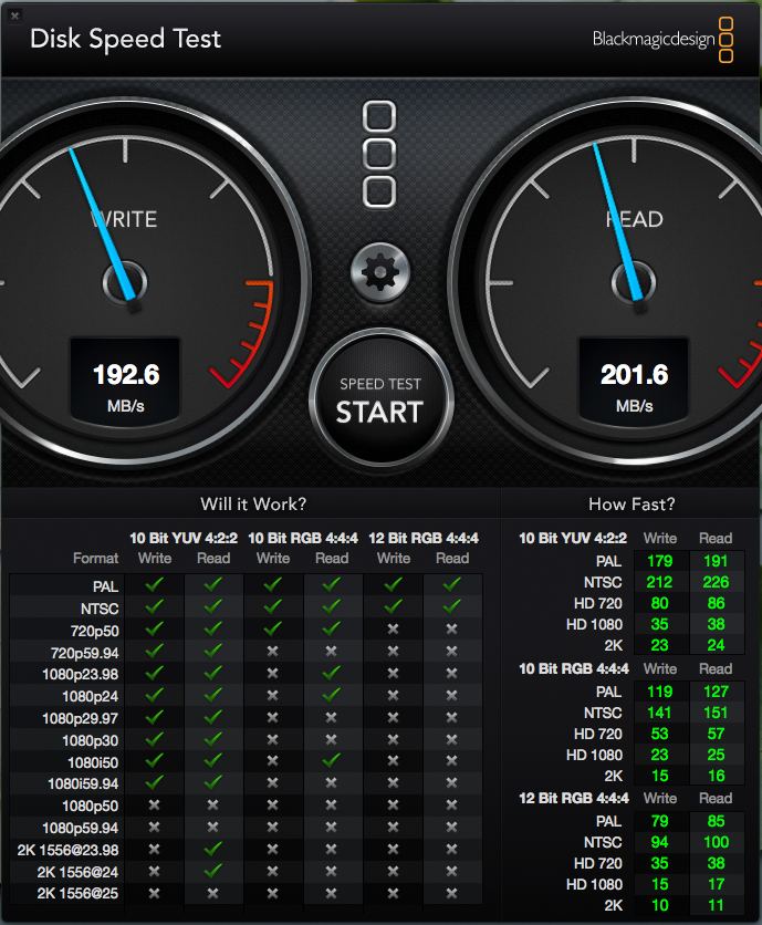

Seagate 3TB USB3.0 drives have exceptionally fast drives for their low cost. The 7200rpm drives in the enclosure come very close to velociraptor read/write speeds. The 4TBs are also fast but Seagate has started making 5900rpm drives instead of their original 7200rpm so the 4TBs are hit and miss with what you get.
I get around 200MB/s read/write in black magic on the 3TB USB3.0
