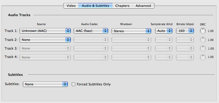

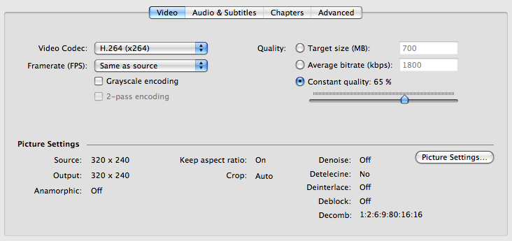

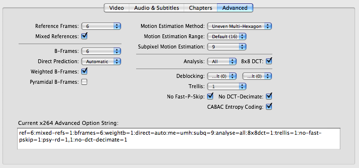

After lots and lots of tweaking this is the best setup so far for DVD-rips. I spent a long time researching and tweaking the "Advanced" section for best results.
Plays perfectly in iTunes.
CBR 65% is wasteful using newer builds of Handbrake/x264. 59-62% is generally considered transparent.
Personally, I'd just use the Universal preset and be done with it.
The universal preset doesn't have all of the tweaks to the advanced section. It will still work but it's possible to have a smaller file at higher quality with the right tweaks to to this section rather than using the "Universal" preset. And thanks for the tip on CBR, I'll have to give that a try.
I usually do 65 too. I'll try lower. one of the first movies I converted for ATV was the first Harry Potter. There's a scene at the start at night that was very blocky on 62%, so I tried 65% and it was a lot better.
