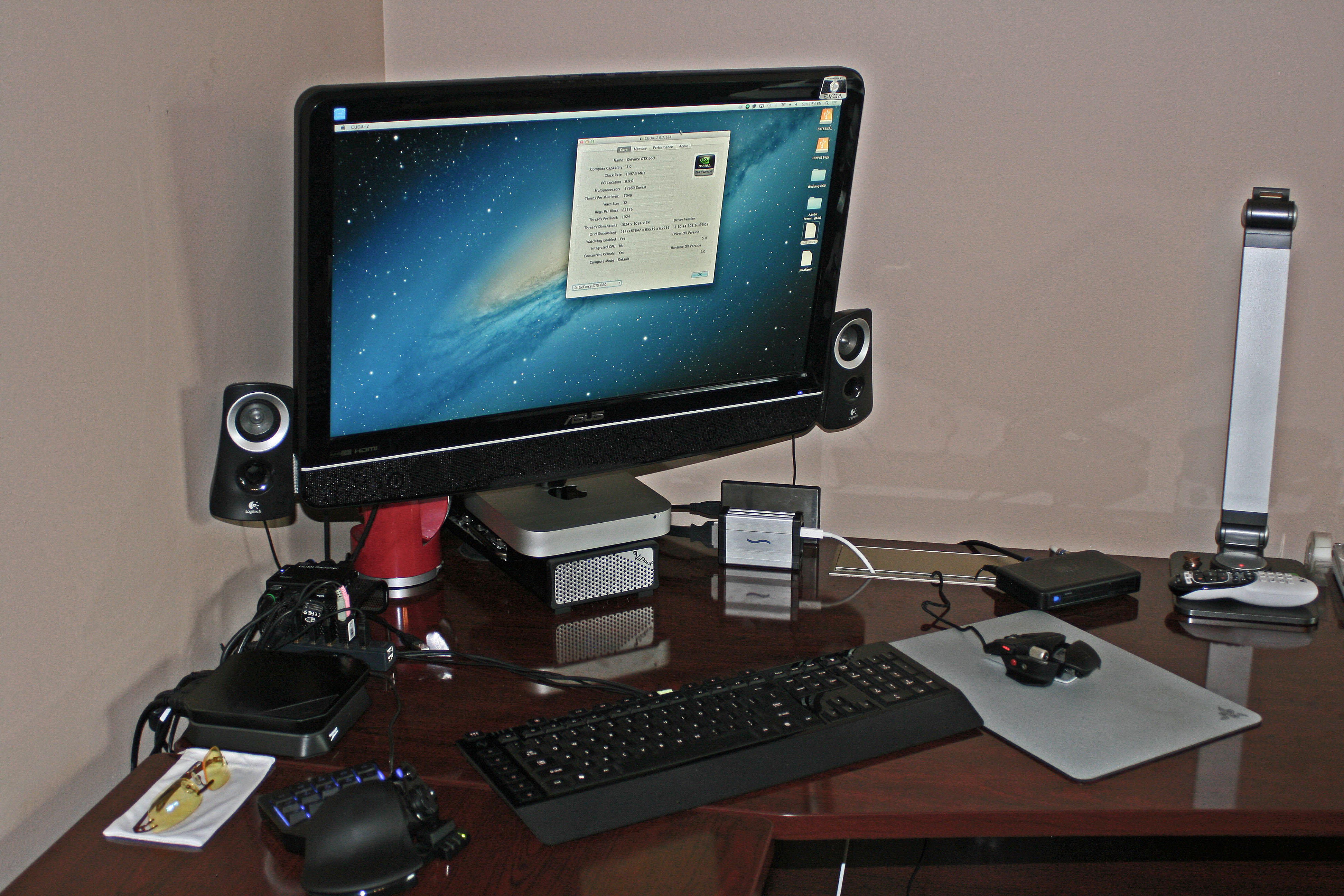

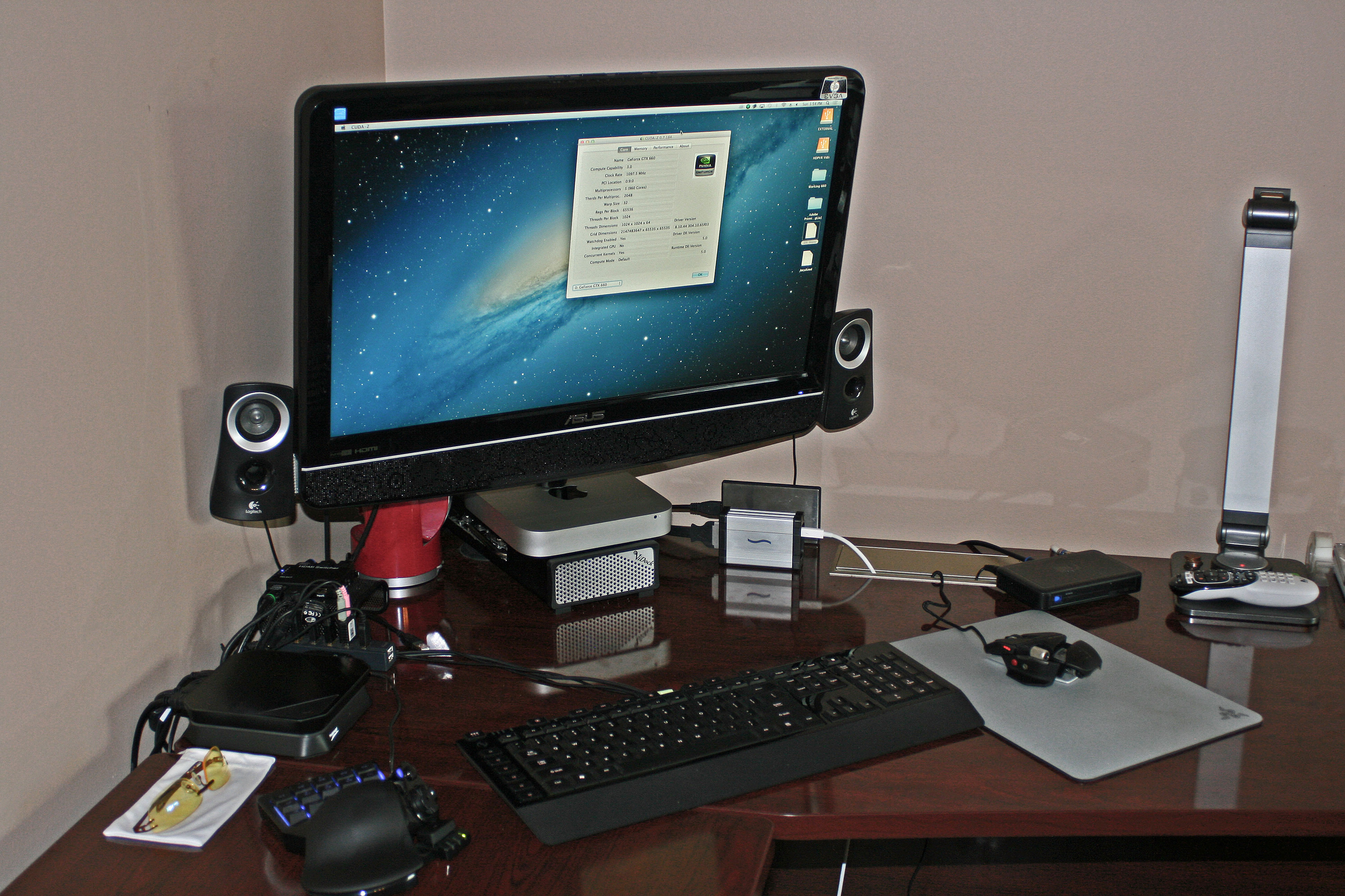

Not sure if a Titan would work. Technically yes, but it may not in OS X. This is my current setup below. It's a Mac Mini connected to a ViDock GPU enclosure. Are you planning on gaming on OS X or Windows?
Also, keep in mind that if you purchase an iMac, you will not be able to use the internal screen and you'll have to purchase a seperate screen. This is because nVidia Optimus lets you use the internal screen as long as you have a Integrated Intel GPU (only the low end 21inch model has one, so that might be the best option for you). I bought a mac mini because CPU wise it is close to the imac and the nVidia optimus gives me a huge boost in performance.
