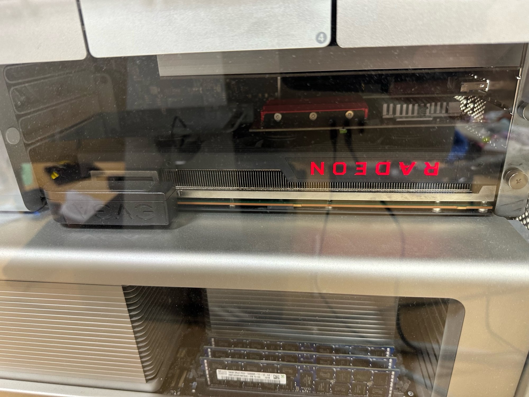

My magic potion is a combination of an AMD 6800XT card out of an Alienware Aurora R13. Only this particular card comes in a two slot design because the Aurora R13 is only a Midi Tower and very cramped. Its the most compact XT card out there to my knowledge. I use this card together with a Pixlas mod cable and EVGA's Power Link. If you use Pixlas cable, you usually don't need the PowerLink as well, however it was left over from my Nvidia 980TI days in my 5.1 about 5 or 6 years ago. This way you have Slot #2 free. In terms of most speed and best Airflow for that GPU, the Ablecom dual card is the second part of this recommended configuration.
(ableconn pexm2-130 dual pcie nvme m.2 ssd adapter card - pci express 3.0 x8, supports 2x m.2 ngff pcie nvme ssd for mac & pc (asmedia asm2824 switch) - non-bifurcation motherboard compatible)
The Crest I/O dual card I have in slot #4 would work as well, however this and other 4xSDD cards are large and restrict airflow to that GPU underneath. So in terms of airflow optimum, the very small Ableconn dual card is the prime choice between speed and airflow for GPU. You can see how much space is left for the GPU in the picture.
Every other bridge card is much larger and heats up GPU.
However, what was very surprising to me, the AMD 6800XT card runs exceptionally cool and the fans stay silent for a very long time during normal office work. It is way cooler than past Vega 64 and Vega VII cards I used to have, after Apple forced all of us the NON-Nvidia path. The technical advancement between the Vega VII and the 6800 Series is substantial in therms of thermal load.
For Monetrey, this upgrade combo together with the USB2 Header Upgrade to bring back full USB functionality
is highly recommended.
On top to that, I had the GPU flashed from MacVidCards in Poland. This way its fully bootable and works great in Win10. If you go this path, you will need to us also MacVidCards recommended Version of OpenCore. Its a bit older on the Version, but it works flawless without a single hick-up. I am super happy with the current setup which gives me a lot more waiting time to watch MP 2019 price tags tumble.
