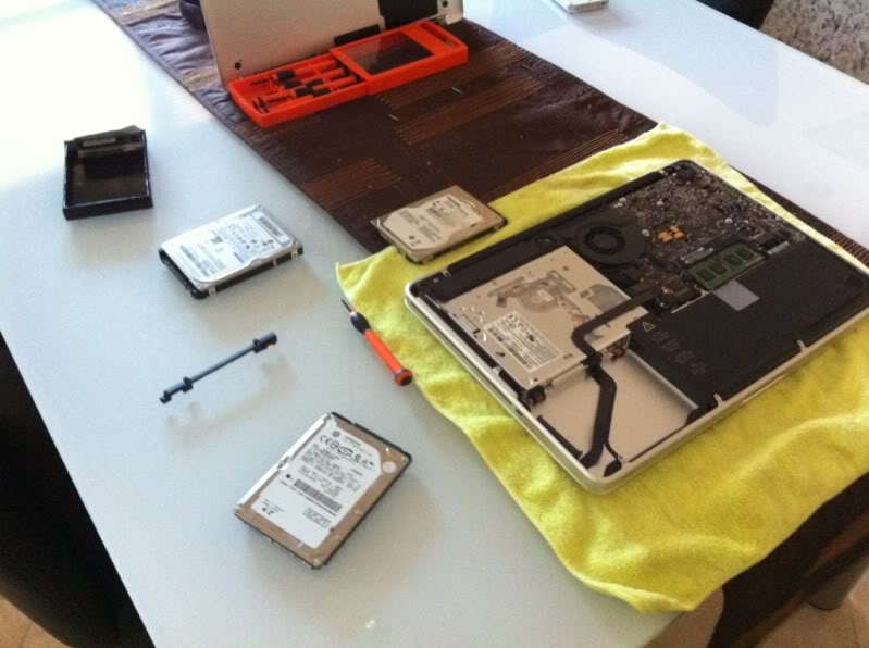

I would like to upgrade to 1 TB ideally.... I currently have the 320 GB HD in my 2009 13" MBP. It originally came with the 250 GB but I had them install the 320 when I got it.

hi mate, yesterday i was at my electronic local shop, and found me this
external hdd http://www.verbatim.com/prod/hard-drives/portable/acclaim-sku-97393/
very small, my idea was to use it as an external hdd for media storage and for backups. i was using a 500g hdd on my pro, but i was getting closer to the 500g. so i tough since the verbatim was so small, it is 2.5'' same as the one MacBooks use, the only thing i was worried about was the high of the hdd, the 500g i was using was 9.5 mm and the verbatim was 12.5mm, its a samsung hdd actually 1tb at 5400 rpm rebranded verbatim.
so i made a clone of the 500g to the 1 tb ,with carbon copy cloner, took out the 500g and put it the 1tb and now its working like a champ !!
now i have 400 gigs left to use :D
hope this help you
pic

and iKIKO: I take it the extra few mm's in height didn't cause any trouble?? So let me get this straight... you bought a USB external HD, carbon copy cloned your internal HD to the external one... then took apart the USB external drive and put that drive in your MBP?? I didn't know you could dismantle the USB drives - or even that they would be compatible!

yes, thats exactly how i did it bro. works perfect, carbon copy makes it real easy on the cloning a hdd. i guess not all the external hds are removables for say it that way. but i had the luck that the one i bought was :D
its 5400 rpm, fast enough for me, my dad's mac has a 320g 7200 and i can't tell that much difference between his 7200 and my 5400. and i think the 7200 will consume more battery (correct me if I'm wrong)
so, now you know that you can put in there a 1tb 5400 12.5mm thick hdd :rolleyes:
