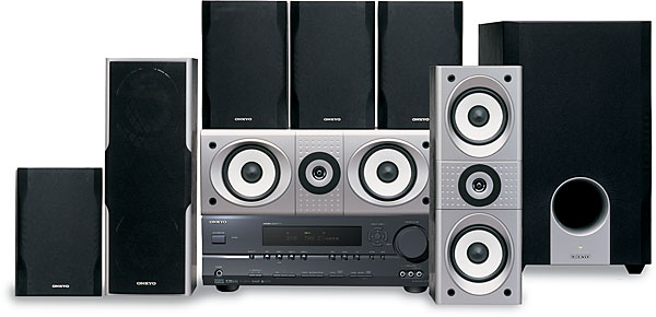

You absolutely cannot beat the Onkyo HT-S790 at present. The receiver has a ton of options, its well built and the speakers are quite nice (plus its 7.1). Plus its only $499 ($450 on sale).
I have it and it really does a nice job of delivering. I haven't heard it distort anything and it sounds brilliant delivering whatever you are playing through it, be it stereo music from an iPod or CD player or Dolby Digital EX from a DVD. It'll even turn stereo into 7.1 using Dolby Pro Logic IIx processing which actually does a nice job. The sub is nice and low but really kicks in when needed for movies and music.

I would go for the 7.1 version because the speakers are of higher quality. The 5.1's are smaller and cheaper.
I was trying to avoid 7.1 if only because the installation would be significantly more complicated -- the side speakers would have to go in a very awkward location. Either way this is going to require a lot of time in the attic and in the crawlspace under the house -- so I don't want to do it again for a long time!
Onkyo really uses different speakers in the 5.1 system? This is verified?
Well, you're looking at cabinet bookshelf center and front speakers in the 790,while you get much thinner curved 'bookshelfs' in the 590. Like said, just don't use the 2 rear centers, that's all.
The Onkyo looks really nice, but would it be too powerful for a bedroom or dorm room? If so then I'm probably going to go for a cheaper alternative like the Samsung HT-Q45...consumer reports rated it a best buy (but they also loved the Onkyo, rated it best sound and features). And what does the "HDTV Capable" (on the circuit city site linked in the previous posts for the Onkyo) mean?

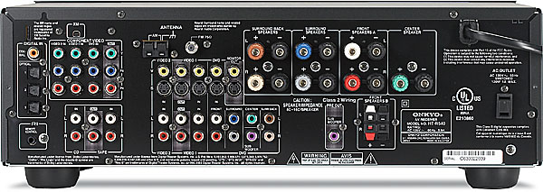

I've been looking at this system also and have a few noob questions about installation. Basically what I would like to do is have the wires run through the walls/attic with a 7.1 banana plug wall jack (ala this.) When hooking the wires into the receiver, is it just bare speaker wire on the receiving end? How about on the speaker end? I know I'll have to put banana plugs on the ends going to the wall, I was just curious about the other hook ups. Thanks
