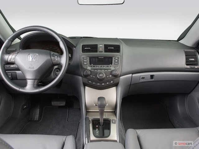

As mentioned in the OP, it's the stock head unit. See attached photo:

I'd like to keep the stock head unit - what I'm asking is what's the best way to interface an iPhone 5 with a stock head unit so I can play the audio through it?

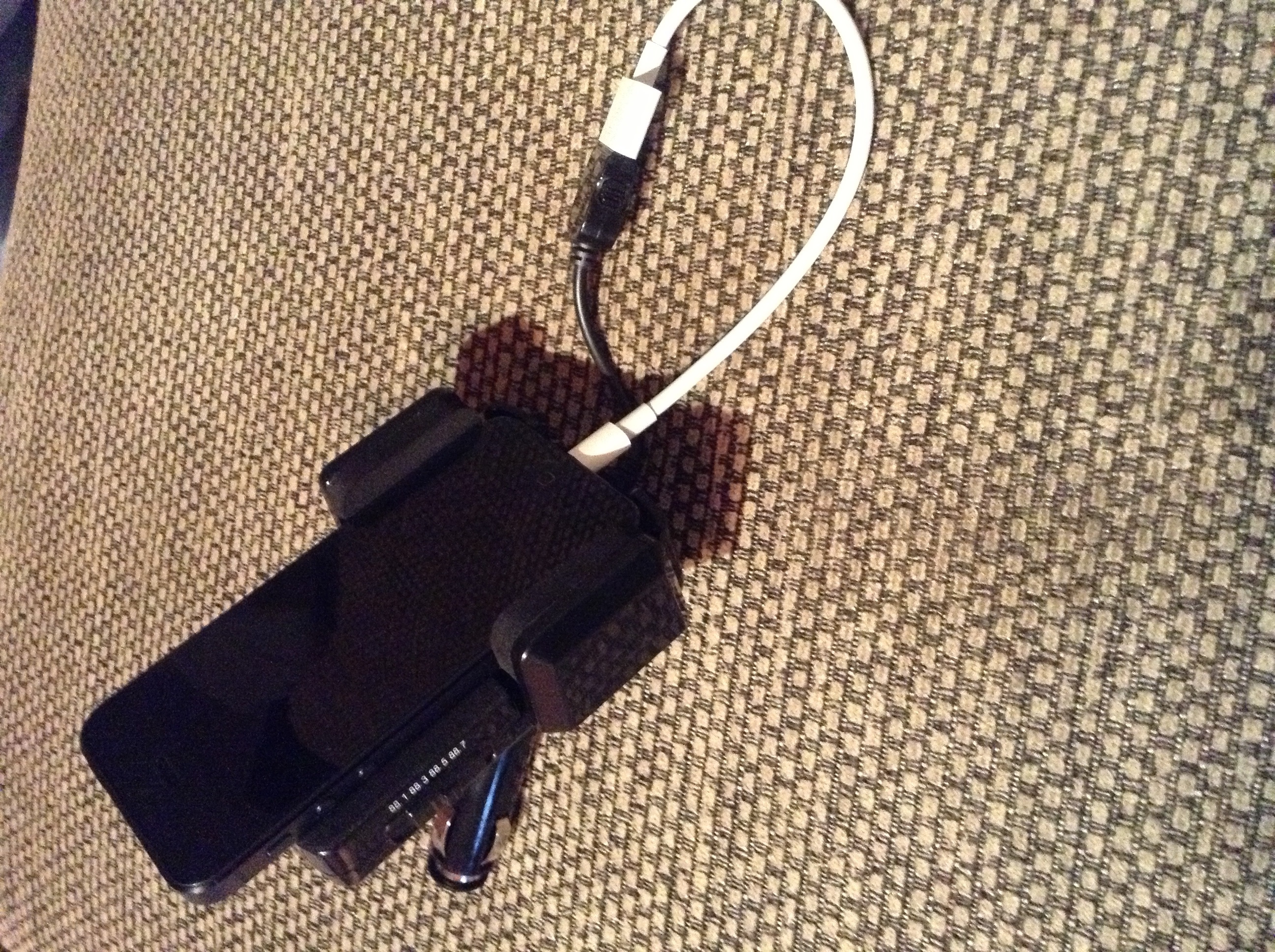

You can also just use an fm transmitter so the sound plays over the radio but it's not the best audio quality. Here is one I use in my company truck. It's called the Jam Cast.
